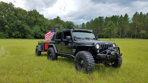

Here's my 2015 Jeep Wrangler build, First vehicle I have ever bought new and had it torn apart before I even put the first tank of gas in the jeep!
Rock Krawler 3.5" Long Arm lift.
ARB Lockers front and back
ARB onboard air
4.88 Gears
welded truss and gussets on stock axles for support
37" Nitto's on 20" rims
Rock Hard bolt on Roll Cage
Rock Hard skids underneath
EVO weld on sliders
Poison Spider front and back bumper
Bedrug Bedtred floor liner
Warn 8k winch
Spod/Lights
Body Armor trail doors
I'm sure there's more I haven't mentioned! but that gives you an idea of what I'm working with. Check out the youtube video if it will play..
