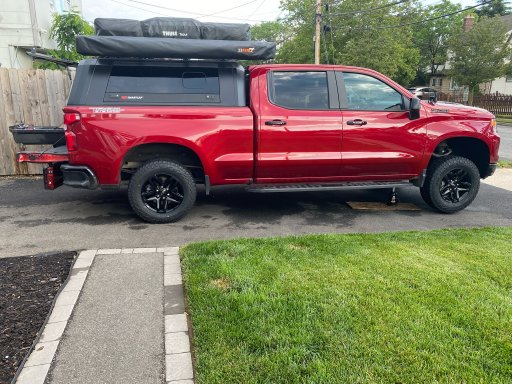

Looks great! You level it or put on a small lift? I just leveled my 2020 Trailboss so I could cram 295/70/18 on the stock wheels. Super happy with the Cognito lift. Also just finished the rack in the back.Finally ready for tent.
2” in back about 3-1/2 in front, but I didn’t start with a trail boss, so you have a 2” head start. I used icon adjustable remote res front and rear plus blocks in back. 315 70 17 (35”) on 17” 0 offset. Had to remove the factory little mudflaps and their brackets in front and screw the fender liner out of the way but no rubs!
315 is big! What brand lift did you go with?

Disregard….looks like you did the ICon adjustable…legit setup

Yep icon. Important not to skip the upper control arm. You may pop the stock ball joint out with the little bit of lift and increased articulation. Trail boss may have already addressed it with the factory lift. There are a couple of stops that you’ll want to remove that’ll allow for more suspension travel as well if you have struts and control arms that can do it. AND, what a difference in ride, even just on the street. Whole different truck.
Yep. Already done. Cognito level kit is made for trail boss and comes with new upper control arms.
