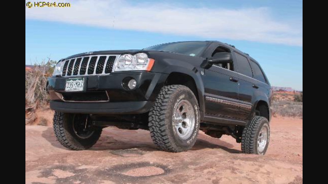

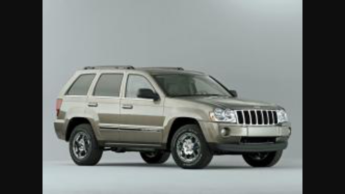

Question for y'all: I have a Jeep WK that has the factory aluminum 17" rims. In the future, a year or so when it's time to replace the tires, I was thinking of changing my tires to 32" or 33" and lifting it up 1.5" to 2". Nothing too outrageous. At any rate, I had heard that maybe for off-road use I should swap from the aluminum rims to steel. Is that necessary? My intent for my car isn't heavy rock crawling, but some kind of typical off-road, at least more than dirt roads.
My car currently looks something like this:
I'd like it to get to this look:
Can I keep my existing rims?
Thanks!

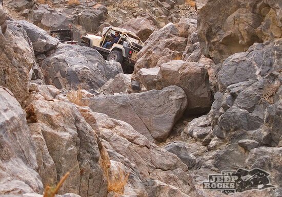

I think I may be in the minority here.. But I've been in the rock crawling world with a built jeep on 37s where I could see a valid reason for wanting steel in case the rim bent.. But in the Overlanding world, I have yet to hit a trail where that would even remotely be a worry of mine...
Here are some of the hammers trails we used to do in our jeeps that would warrant worrying about bending a wheel..

Yikes! Where you see a trail, I see boulders! That's awesome! But not the kind of thing for me...I just don't have that kind of experience at this time.
