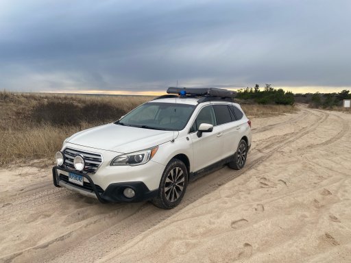

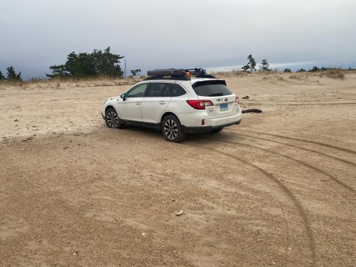

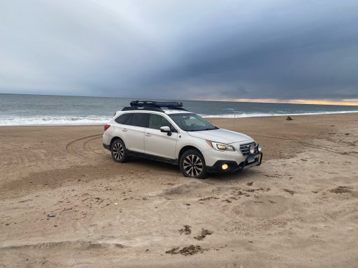

The short answer to this is yes… however while this unintended adventure was fun, it also made me really nervous. This was my first time driving on sand like this period and I wasn’t really prepared well for this. With good tires, (I’m running falken wild peaks) it’s possible but honestly capability wise I strongly stick by AWDs are not the same level of capability off-road as a 4wd regardless of modifications. Had this sand been any softer I’m not sure I could’ve gotten out. I’m sure I’m the first to do this with a Subaru at this location that said 4WD only after a point but I definitely wouldn’t recommend it lol.

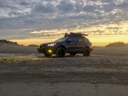

I have a ton of experience driving a modern Subaru on the beach and they’re extremely capable regardless of sand conditions. All the same attributes that make them superior to other vehicles in winter still apply but in the sand they also benefit from being much lighter. Admittedly my Outback was far from stock but I wouldn’t hesitate to drive on sand for a second. They, like their typical 4wd counterparts, are not immune to driver mistakes though. Knowing how to drive on sand is a learned skill and you should always make preparations as well as have, at a minimum, the right tools to help keep yourself/get yourself going.
Modern Subarus are only really hampered by the nannies you can’t disable 100%. They’re especially obtrusive from a stop or very slow speeds. Knowing this can help avoid putting yourself in a bad situation. Put it in x mode, hold the TC button til it’s off as much as it can be, and drive in manual mode.

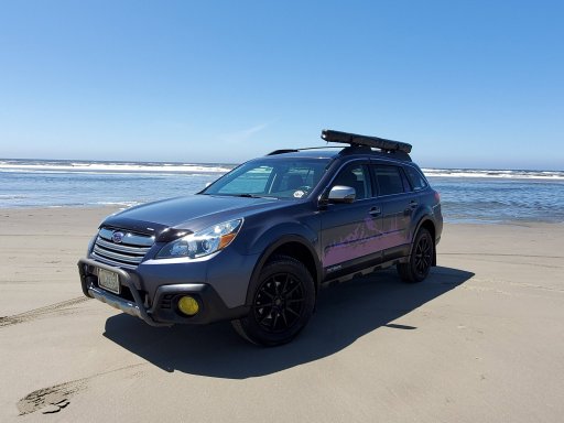

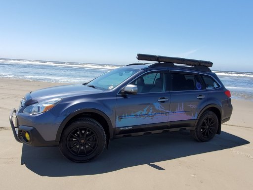

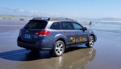

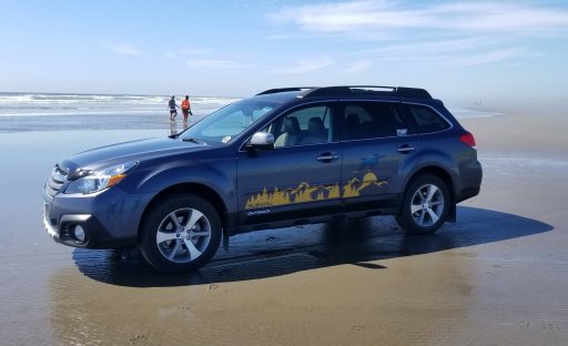

I have a good amount of experience driving my Outback on the beach but up in the Pacific Northwest. I did it when it was stock as well as with my lift on it. When I did it, I mainly did it where the sand was not deep or super soft so that it was not likely to get stuck. I am not saying that it couldn't drive in the deep soft sand but I did not have the equipment to handle the deep, soft sand. Sometimes I would turn the traction control off in order to get on the beach.

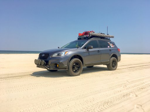

View attachment 248615View attachment 248616
Just chiming in to say that's an awesome looking rig! How much of a lift is that?
