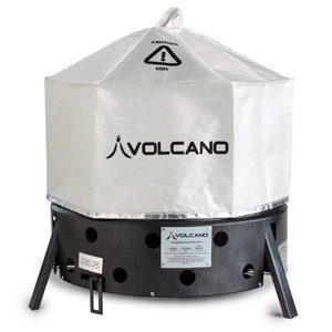

Also if you have a dutch oven volcano, you can use the propane ring (or coals) inside that, with the dome over it all. Really even heat that way.
