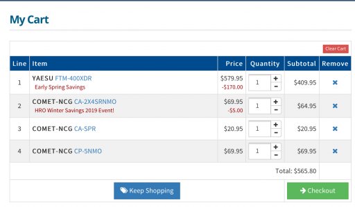

7980A8A0-93FD-49F2-BDEA-0D915C31D6F9.jpeg Like the title says I have my cart ready from hro. What else do I need? I just passed my tech test and this will be my first radio. Should I get a specific programming software? I’ll probably do a APRS setup later down the line.
In my cart now is my radio, antenna, mount + cable, and antenna spring.
Thanks!
Looks like just the RT Systems programming software is all you're missing. Unless you're planning to manually program it, that is.
You probably already have, but yes get the RT software. I programmed about 75 repeaters to the sd card in about 15 minutes using the software. Well worth the 25$. It has access to repeater book built right into it.

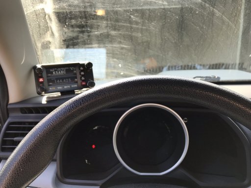

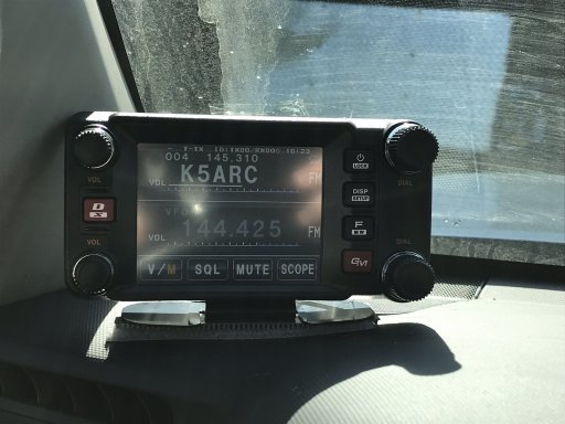

On mine, I bought a ten foot extension for the mic and just tuck it in the console through one of the power cord gaps. The control head is sitting on the left side of the dash next to the A pillar secured with 5 pound rated Velcro to facilitate quick removal when not in use.
Wife is gone in the truck ATM, but I’ll snap a pic and post it in the morning when I get back home from work.
I ordered a Lido mount with the mic holder tonight. It's the one that mounts under the seat. I hope it is strong enough to stay erect during high speed travel off road.
It should hold up fine. I looked at a similar one, but I’ve already got a GMRS radio and my tablet in that area. The wife commented that she was running out of legroom so I went the Velcro route instead.
Here are a couple of pics for reference (Sorry for the dirty windshield. The pollen is horrible here right now.)
