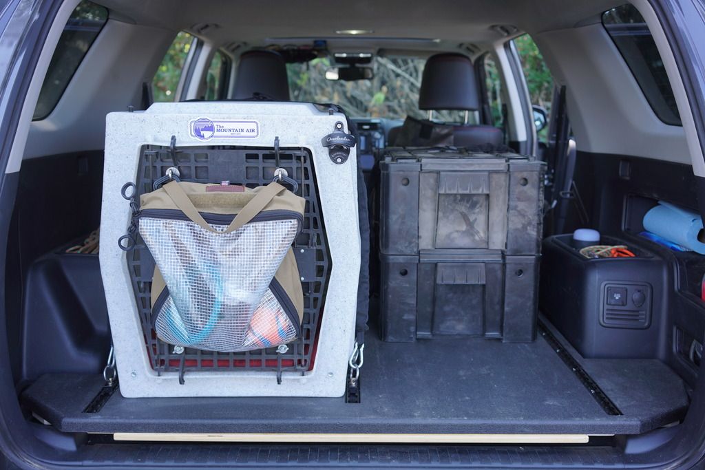

When I first bought the 4Runner, it didn’t take long before I realized that I would need to modify the stock cargo area to best fit my personal needs. I had a few basic requirements to consider:

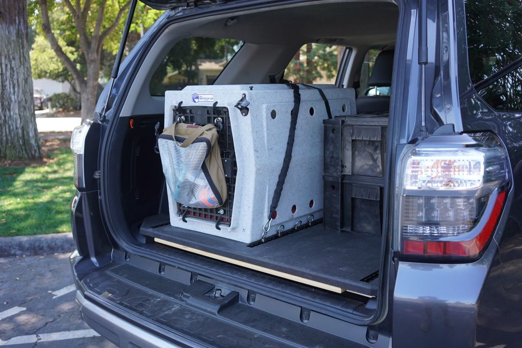

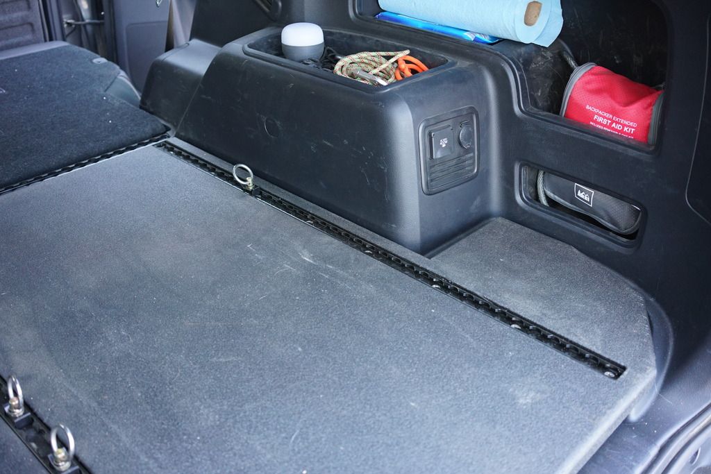

Cargo Security:
My typical cargo usually consists of the Ruff Tough kennel for the pup and a Front Runner Wolfpack (used to be Action Packer). When I switch to camping/Overlanding mode, I will typically add my camping box (DeWalt Tough boxes), the cooler, and other miscellaneous small items. All of these things needed to be secured in case of a collision or other accident. The last thing that I want is for the dog kennel to smash around, or to see a fully packed Yeti cooler cruising through the windshield. A tie down system can also be more practical by keeping your gear secure when four wheeling as you start/stop/pitch/jolt. It was really clear that the stock 4 point system wasn’t going to cut it after a few 4wd trips, however for the better part of a year I have made it work.
A Fully Flat Cargo Area:
The 4Runner (without the OEM cargo tray) with the rear seats folded down does not allow the cargo area to be flush with the rear seats. It’s about a 2-3 inch drop, and that drop makes a huge difference when it comes to sleeping comfortably in the back. Like my issue with securing cargo, I was able to make it work using a yoga mat, and an extra blanket. It worked, but I slept terribly.
Additional Preparation Space:
When I camp and spend time outdoors, I tend to need a flat surface to perform various tasks. Cooking, organizing gear, working with maps, etc. In the past I have made due with cooking on my camping box, requiring me to pull everything out that I will need for the meal, and ultimately I forget something mid-cook. How hard is it to open the camping box while there is a full pot of water boiling on the stove? It’s very difficult, trust me. Sparing myself buying a table for camping, I thought having something that could be easily deployed when needed would be a great addition to this platform.
Room for growth:
When I design/start any project, I understand that even if it is well planned, and even better built, there is always the likely possibility that I will find some way to make it better. So I incorporated that reality into my build by using materials and a general layout that would allow me to incorporate drawers, a fridge slide or anything else later on down the road.
Note:
I won’t be going into full design details with this particular project at this time, mainly because I am contemplating doing a small production run of this platform once I give it a good shake down to test the integrity of my design. Once I can establish that there aren’t any weak points, I will consider moving forward if there is a suitable demand. In the meantime, I will be pricing the unit as it is currently designed because I understand that the first question many ask with this sort of product is “How much?” That’s what I am going to work out.

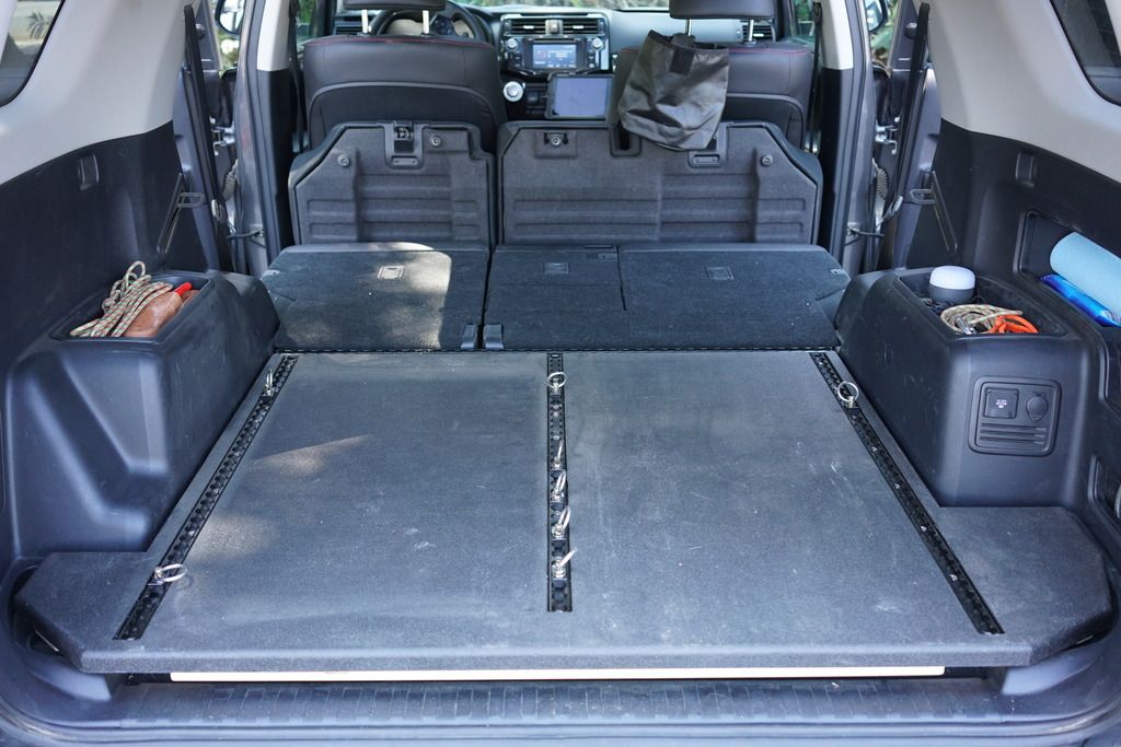

Product details:
-Baltic birch plywood construction
-Aluminum L-track tie down strips with movable tie downs
-Line-X platform coating
-Stainless steel hardware
-Minimal modification of the 4Runner to fit (plastic trim removal; no cutting)
-Flush to seat design
-Slide out preparation space

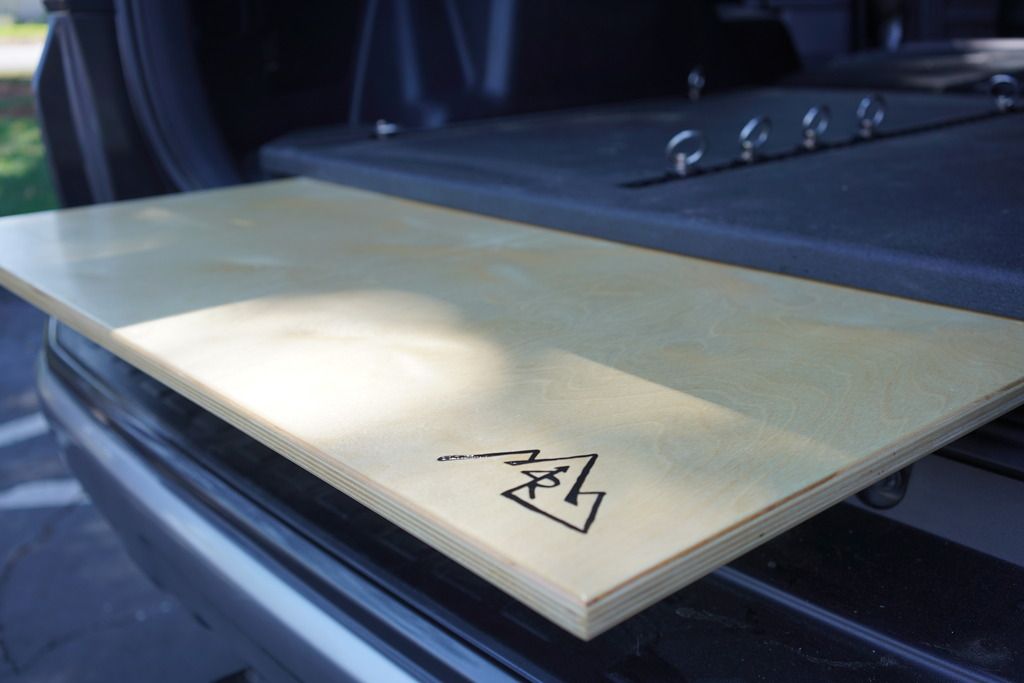

Product Description:

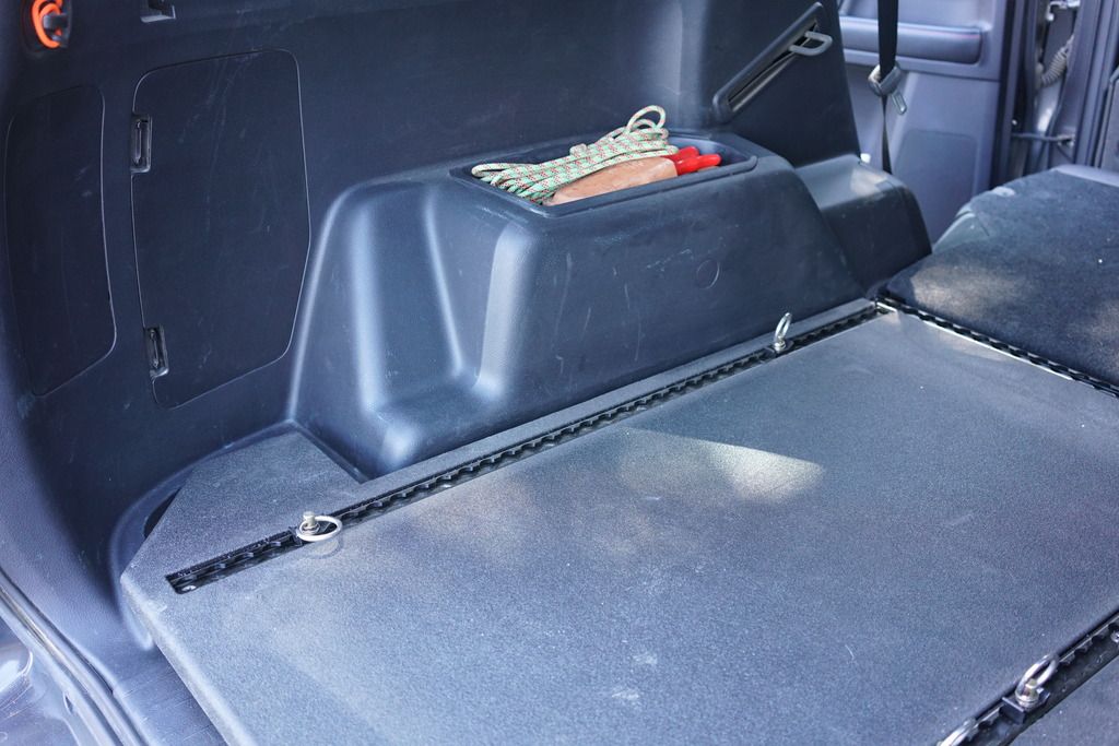

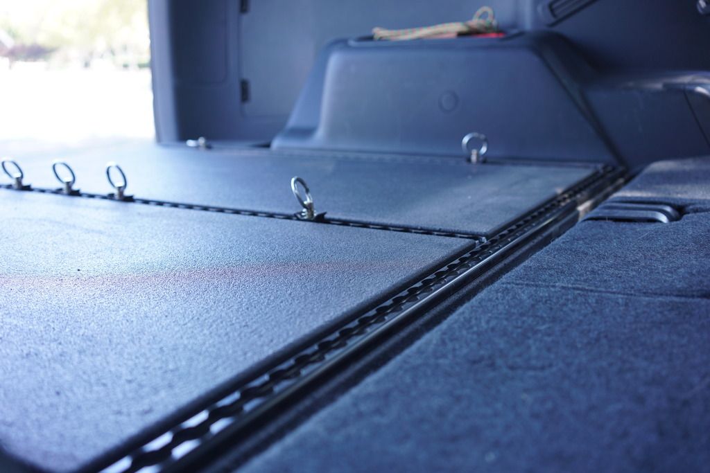

The platform is constructed using strong, Baltic birch plywood. It is made of a hardwood ply, and unlike cheaper substitutes, it doesn’t use a weaker filler between the layers of hardwood. It is hardwood through and through making it very rigid and durable. The plys are bonded together using marine grade adhesive, and the outside veneers are thicker allowing for a more durable surface. It’s not a cheap material to use, but the benefits well outweigh the cost.

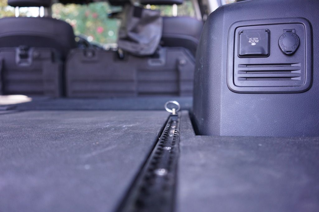

The platform incorporates 4 aluminum L-track strips. Left, center, right, and against the rear seats. Each one with approximately one tie down option every 1-2 inches. This means that as cargo needs change, so do the tie down points. This variable approach allows for securing different cargo in different arrangements without compromise.
A Line-X finish on the platform was used to increase the base material’s overall strength, provide a waterproof finish to the top surface, and to increase the long term durability of the platform. As an added bonus, it ended up looking like something that should have come from the factory as it closely matches the plastic color.
The slide out is made of the same Baltic birch plywood, but with an added polyurethane surface protectant to seal it from water and other stains. The edges have been routed to provide a smoother grip when extended. The slide can come out approximately 18” with enough rigidity to hold a stove and food preparation supplies. It is branded with the Mountain 4Runner logo on the lower right corner.
The platform attaches to the 4Runner using existing threaded holes, and only requires the removal of 2 plastic trim pieces. No cutting is required for installation. It fits with approximately ½” per side to spare, and enough room to fold the rear seats up and down without interference.

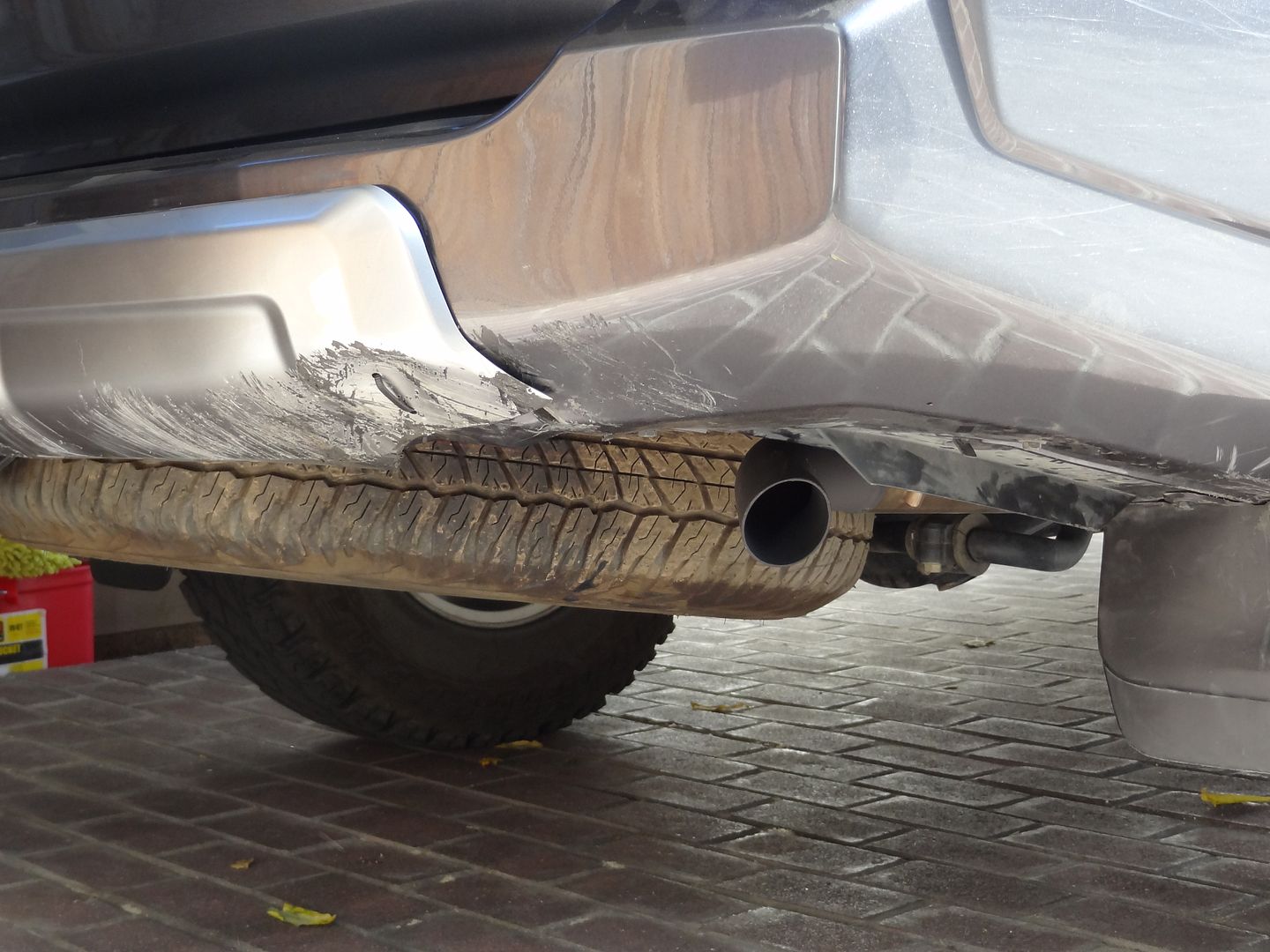

After the exhaust tip was a bit... squished... after the last trip, I took it upon myself to knock out 2 birds with one stone; cut the exhaust back for better clearance, and turn the tip out to the passenger side to eliminate exhaust fumes from entering the back window. The stock piping is 60mm, or 2.38" more or less. We made the tip out of 2.25" pipe, and the direction/angle is spot on. The fumes have been eliminated, but I am going to have this tip replaced with one that is 2.5" because when I get on the skinny, it makes a nice (and by nice I mean unappealing) whooshing noise which I think is because the tip is just slightly smaller than the stock piping. Oh well, live and learn.

A few weeks back, after crumpling my exhaust tip at Bald Mountain, I had a new tip welded on at a local shop that pointed slightly out to the passenger side. After spending a weekend at elevation with the back window down a good portion of the trip, my exhaust smell problem is almost non-existent. I was able to smell it a bit as we climbed a winding, slow grade outside of Donner Lake traveling at about 20mph, but that was it. It came and went quickly. Very happy for a $20 mod. It also allowed me to add a second recovery point that I picked up from a friend when I helped him install his CBI bumper swing out. If you haven't done an exhaust tip, it's worth the small amount of money to have it done

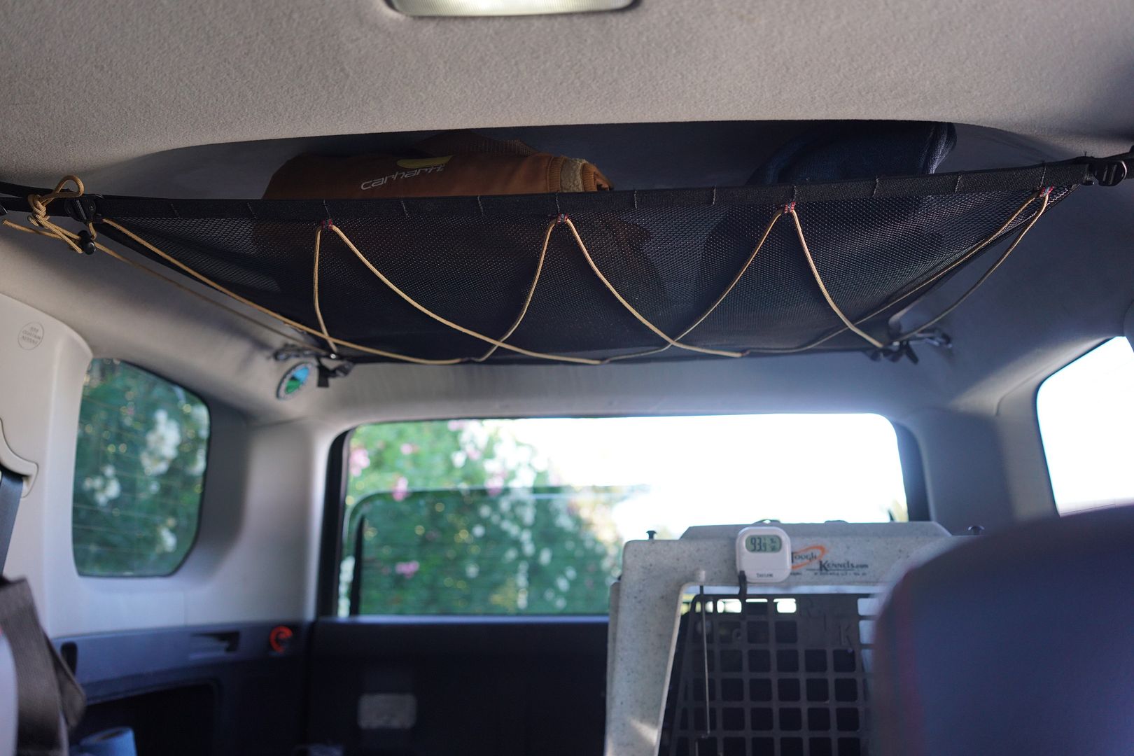

This weekend I installed The Attic from Blue Ridge Overland Gear. I wanted to add more storage for light objects (blankets, jackets, sleeping bags, etc.) while using previously unused space.
Installation:
The install was a little tricky, but I eventually figured out my own method the best way to install the attic. I used the left over stock cargo tie downs to replace the standard clothes hooks. Then using a carabiner, I hooked the outer most loop of the attic to the tie down. I installed the front attachment points as BROG had designed them.
Impressions:
The dimensions fit the 4Runner well, and the design allows for a good amount of 'stuff' to be stored up top. Anyone sitting in the backseat over 5'6" - 5'9" could bump into the attic, but for me that's a non-issue as I rarely have people back there for long distances. Removing the attic is fairly simple if cargo needs change, allowing for the best headroom possible. Once I get this thing on the trail for an extended trip, I will update this post.

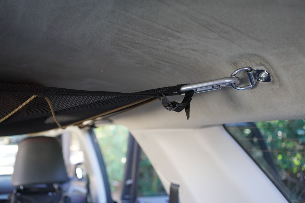

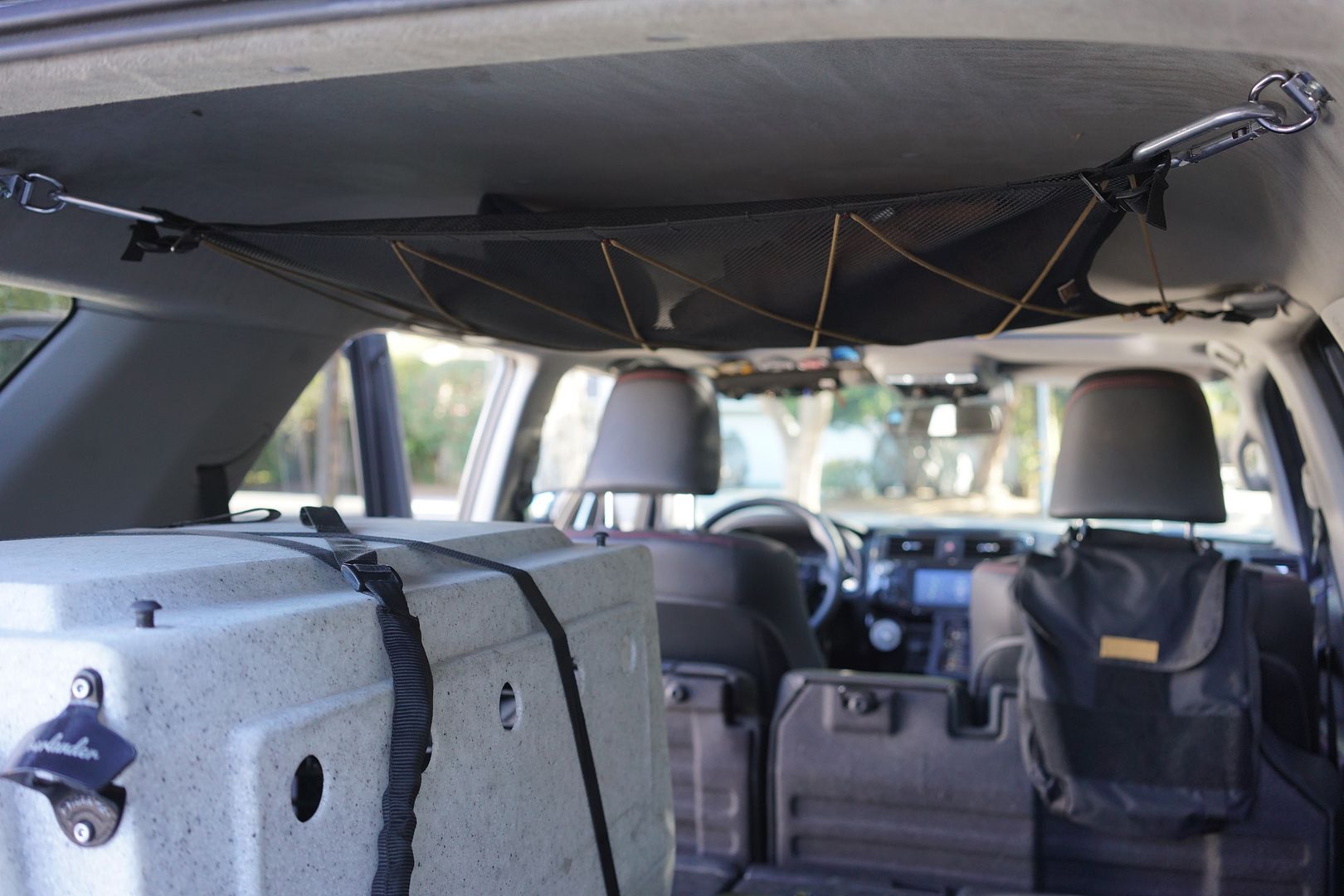

The sleeping situation in the 4Runner has been improving, but it needs some further refinement. Next steps will be having a foam pad made to fit for the passenger side of the back that will give me more support than the blow up backpacking pad that I have been using thus far. I also removed the back seat bottoms to gain some extra storage room, and head room when I am sleeping. 2 bolts, and I can throw it back in there when I know I will be having people in the truck. I have been tossing around the idea of removing the driver's side rear seat in it's entirety and building an 'add-on' to the platform that I can attach my water tank to, as well as some other storage. It's a tough configuration because I don't want to end up with most of the additional weight on the driver's side. Hmmmm... Choices... Oh well, stay tuned​
