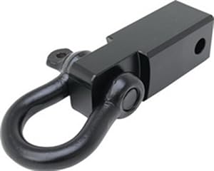

Being FWD I would say some Maxtrax and a winch would be on the top of my list for that vehicle. Make sure you have recovery points, because you're going to need them. If you have a hitch, something like the hitch shackle would be ideal. Normally I would say have a rear bumper with a spare and gas would be a good idea, but your vehicle is basically dragging the rear tires while off road, so maybe having all that weight off the back isn't a good idea.
