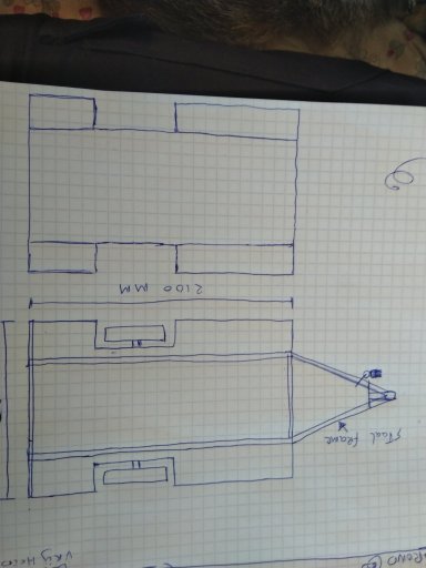

hi to all i schrap my old tent trailer till i was left whit a frame and bottom.
i am looking for some insparation or ppl who want to help drawing for a nice all purose trailer.
i dont got the experiece of a carpenter. any help is welcom

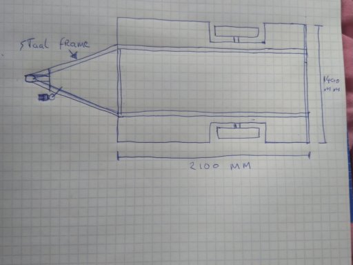

i want to put a box on it like 50cm high and the whole dimensions big exl. wheel arch of course.
on top of the box i want to carrier a RTT.
i will put a picture on to with the dimensions.
note: there are now 12 inch tyre on it but the will be replaced by 14inch met AT tyre

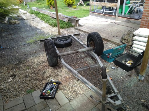

A picture of the undercarriage, axle, spring would be nice too.

under neath is a 750kg torsian axle.

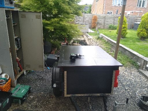

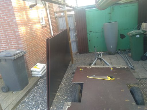

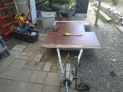

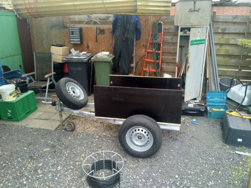

Thank for the anwser. I think i use thick concrete plywood. There is going to be a frameless screw conection. On the picture you see where the frame is and the second one is a top view full plywood frame on the bottom.15894729710531794251570599248238.jpg
Billiebob
I'd just want some support under the plywood floor overhanging the frame on each side. If it were not supporting an RTT I'd maybe not care but a 300 overhang supporting the RTT is too much cantilever in my mind.
Similar to the rear crossmember/bumper I'd want one at the front and one in front and behind the wheel openings. The front cross member could mount on top of the frame, in front of the floor with light steel angle to catch the 300 overhang. With a torsen axle the other 2 cross member could mount below the frame and be blocked to support the floor.
Curious, what is the weight of a sheet of the "thick concrete plywood". I think we call it a different name here.
arjan
This is 18mm thick concrete plywood. It is wheater proof coated. And very stong. and because the box frame is going to be holding it self together and the big support are directly above the steel frame. And the lid will be 1 piece of this plywood so i am not afreight of anything bending.IMG_20200514_185359.jpg

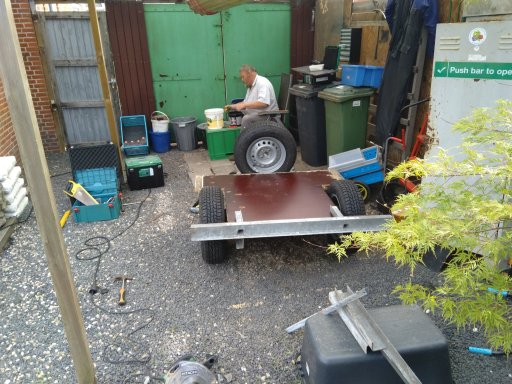

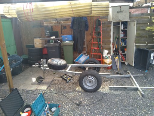

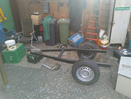

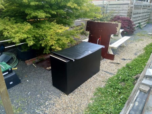

Removing the axle and place it further forwards and then cutting the chassisIMG_20200606_154140.jpgIMG_20200606_154149.jpgIMG_20200606_154156.jpgIMG_20200606_154740.jpgIMG_20200606_160730.jpgIMG_20200606_172744.jpgIMG_20200606_172753.jpg
arjan

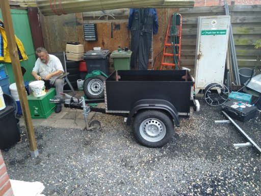

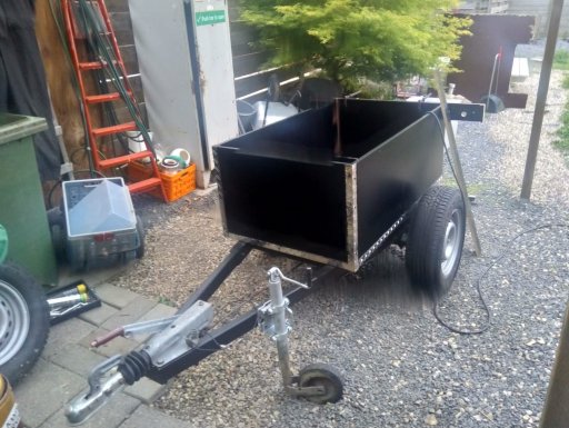

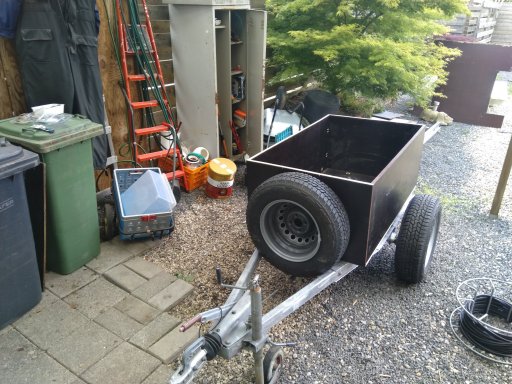

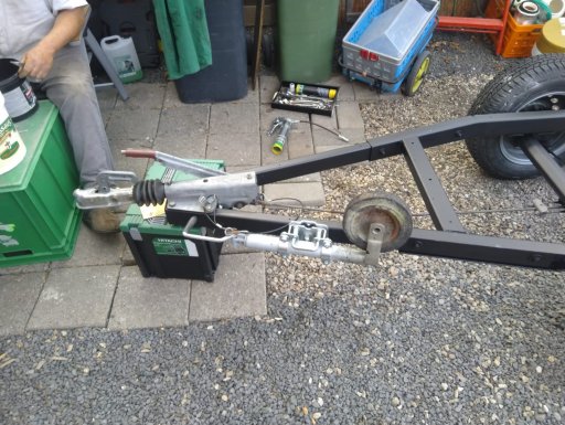

a update of the the build.
got the chassis painted, the box in a vinyl wrap, put a new wireing loom and light on the trailer.
WhatsApp Image 2020-06-11 at 18.35.02.jpegWhatsApp Image 2020-06-08 at 19.15.07.jpegWhatsApp Image 2020-06-11 at 18.35.02 (1).jpegWhatsApp Image 2020-06-11 at 18.35.03.jpegWhatsApp Image 2020-06-11 at 18.35.03 (1).jpegWhatsApp Image 2020-06-11 at 18.35.03 (2).jpegWhatsApp Image 2020-06-11 at 18.35.03 (3).jpegWhatsApp Image 2020-06-11 at 18.35.04.jpegWhatsApp Image 2020-06-11 at 18.35.34 (1).jpegWhatsApp Image 2020-06-11 at 18.35.34 (2).jpeg

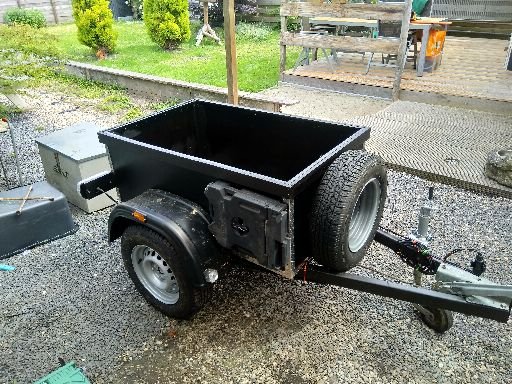

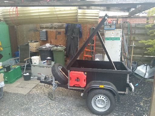

I put the rotopax on bouth sides a 2galon toolbox 1,75galon fuel. For my dual fuel burner from colman.
Made it road legal today licence plate holder on reflectors. Now making the lid and locks. Now waiting for more parts.
arjan

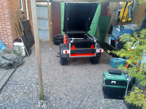

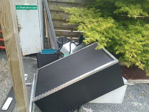

The lid hitch is working like a glove fits in mm to spare.

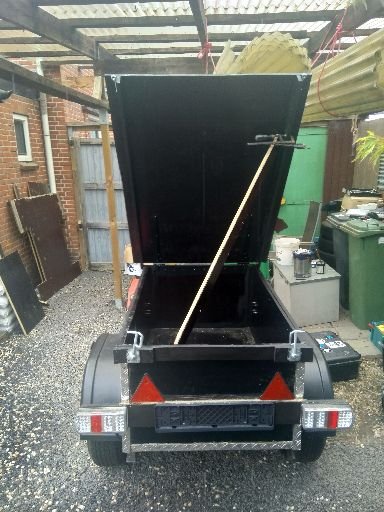

The rotopax on one side os extended and a 1,75galon 6.6liter drinkwater and toolbox. Otherside 1,75galon/6.6liter fuel. Inside aeroplane cargo rails. To make everything secure.
arjan
For now finisht the build. The lid got gas struds and the trailer got new shoes. MT tires. Now waiting for the RTT to put on it and got to adventure
IMG_20200623_215516.jpgIMG_20200621_193749.jpgIMG_20200623_215455.jpgIMG_20200623_215504.jpg
