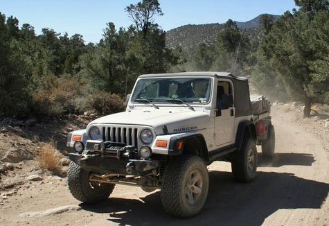

Sounds like your on the right track. 4.10, 33 is a good combo. No lower than 4.56. SYE in my book is a must. Im not a fan of OME springs or shocks. Ive had them in my Toyota's and just don't like the spring rate or the shock valving. In my 04 TJ, I have a set of 4" progressive springs from trail master I think. I went through 3 sets of springs before I was given these. Nice ride on and off road. I can drive long distances in it off road and its smooth.
Your going to want a sway-bar disconnect also. I know your not rock crawling but, on dirt roads as one tire moves up or down, you add in the spring rate from the sway bar. On rough dirt roads it makes the ride a bit better.
When you get the suspension done, make sure your rear panhard rod is flat and your front matches the angle of your drag link (steering). If the geometry is good, that will help your on road handling.
Heres 33's, 4" lift, some fender flair trimming.
