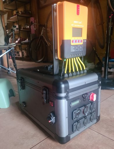

Building your own battery pack is considerably cheaper than some of those high end units that actually last. A quality lithium battery and a small inventory of small parts it's quite easy.

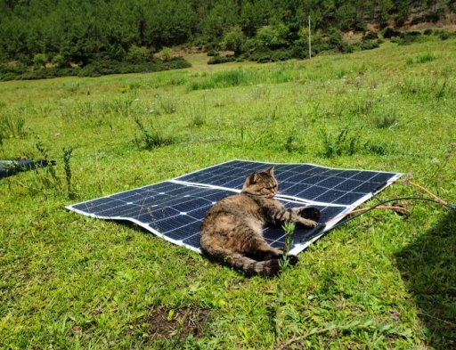

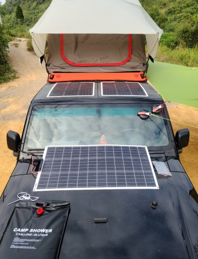

As for solar panels, I mounted 2 x 50w on the roof (perfect for Jeep owners) wired in series that charge while driving. Mounted with 2 sided tape. Then 2 x 100w panels loose and tucked between the roll bars and roof while driving. Again wired in series. (why series...I find it better to add the voltage together so minimum voltage is maintained during cloudy periods)
Lastly...a dependable MPPT charge control that doesn't have to break the bank. My wife and I are in camps for weeks at times...running the fridge...lights...phones and computers. 200w just barely cuts it on cloudy days. A fridge blanket certainly helps.
