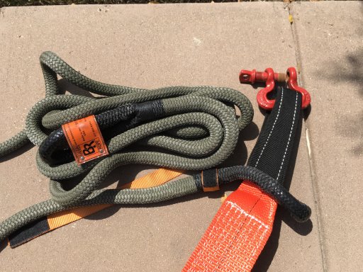

What you need to rig a bridle:
Two Rated shackles:
See: https://www.overlandbound.com/forums/threads/proper-use-of-straps-and-shackles.8405/
One Rated tree savers:
One Recovery trap:

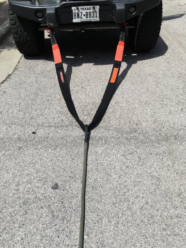

Attach the recovery strap to the bridle,and the bridle to the recovery points on your vehicle
This will give you a distubuted load, and will reduce strain on Unibody vehicles.

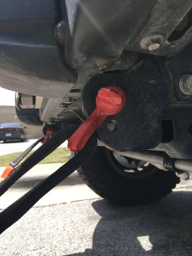

This is the Bridle rigged, ready to be attached to a fellow OB member for recovery.
Remember, that both the person being recovered, and the recovery volunteer must be in agreement on the rigging used. Since you are asking a person to risk potential damage, to their rig if something goes wrong, they get the last word.

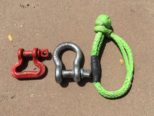

Another bridle that can be used is with a nylite shackle. The main recovery line is placed around a spool and then two legs connect from the shackle ring to the recovery points.
Nylite shackle
https://www.ashoresupply.com/Pictures/502-9641120_L.jpg
If you don't want to fork out the money for a nylite shackle. You can use the eye of the line and then two legs. Bowline knots are used to connect the two legs to the eye of the main recovery line.
http://denverrope.com/images/TowBridle.gif
For some reason the app isn't letting me upload photos of the setup or shackle so I posted the link to the images.

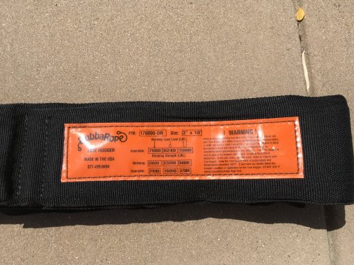

The Bubba Tree saver I use have the built in black chaffing guards. The Bubba Rope (kinetic energy recovery) has a "high performance elastic polymer coatings giving the rope a durable outer skin".

It a tree saver from Buba Rope. Just another use for gear we often carry.
I have 2 tree savers of 2 different colors. 1 (yellow) is dedicated as a tree saver, the 2nd (blue) is my dedicated bridle. Both are static web straps (not dynamic). Both of these 8 foot straps can be used as extensions if necessary to supplement my 30 foot (orange) TOW strap if that became necessary.. So theoretically, 8+8+30+ 95 foot winch cable gives me a long reach if that were ever needed. All 3 straps are of the 30,000-36,000 lb. variety.
The winch is a 17,500 lb rated unit (big boy-Heavy full size)
I also have a (20 ft.)--20,000 lb. PRO-COMP dynamic snatch strap.

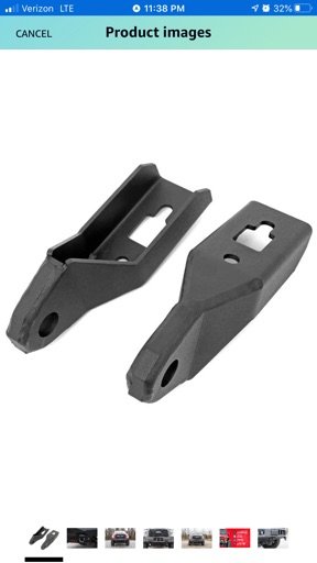

So looking at these Rough Country replacement TABS (post #18), in lieu of hooks, it seems my 2003 does not have support. Probably due to age of the vehicle. Ford has the best and strongest OEM design (closed loop), but you have to use a shackle with with it because it is a closed loop, recovery point design. I always found it strange that North America did not provide recovery products on par with the Australians. The Rough Country offering is a step in the right direction.
When I got my ARB winch bumper, my only concern was that by design and 'spec' clearances, The front left and right front tow/recovery hooks had to be reversed. The left hook was mounted on the right side, and the right on the left. As such, using a BRIDLE is now more problematic, The open ends of the hook are generally in the same 'plane' as the looped bridle, and as such much more likely to slip off when used. A hard mount like ARB offers for the Australian market would have been nice.
The GM 2500/3500 hook design is very robust. Whereas I have seen pictures where their 1500 design recovery hook (BROKE/ failed) in certain situations, Not the scenario you want in a recovery. Best case would be a ARB/Rough Country type design where you add a shackle to attach strap and vehicle when needed.

Excellent points by all. Rough country has out now a way of replacing the oem recovery points on the front of several different vehicles, so you will have shackle points that are rated
