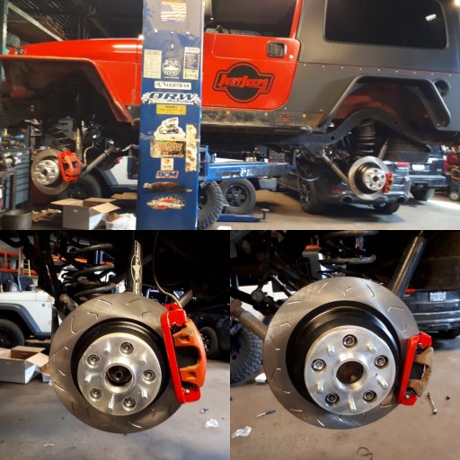

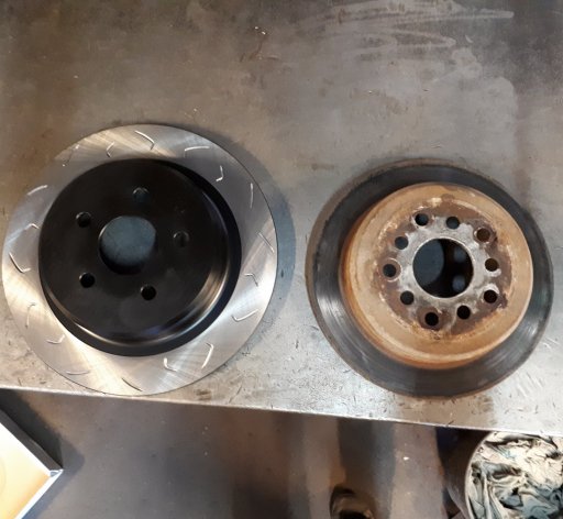

I changed my brakes to the G2 big brake kit and it has been an upgrade over previous ebc brakes. The downside is that they are specialty part when I need to re-order rotors. They provide a larger caliper bridge to get out further over a larger rotor, much like the teraflex and crown kits do in their basic kits. ( ignore that it's a TJ, It has JK axles lol)
