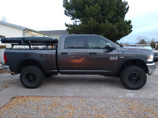

I've done a lot of upgrades in the past few months, but have been behind with my build thread. But here are some highlights.
Modified Front Bumper
I had some problems with my bumper the way it was. Had a good friend rework all the welds, and weld the back side which originally was not welded. Also removed 2 1/2 inches from the bottom of the bumper.
Thuren Parts Galore!
Installed Thuren 1.5 inch front Hemi coils, Thuren Rear Trackbar, Thuren Boogie Rated Front Bumpstops and King Steering Stabilizer.
Also Dodge Off Road Steering Brace

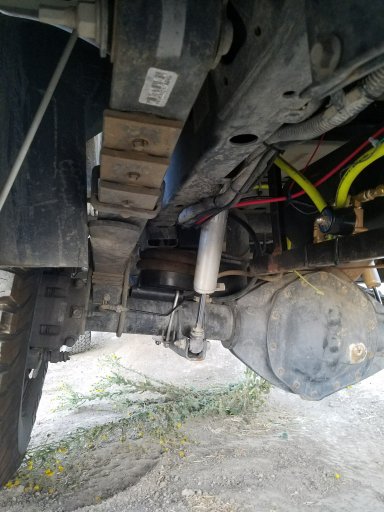

To say you will not loose off road capability is kind of a misnomer. They are around and 1" think on top of the thickness of the airbag top and bottom. With bags and the cradles I did not have any bump travel when unloaded and empty bags. Airbags also have a sharp spring rate curve which sucks going through rough stuff. The cradles do let the axle drop out which is cool.
I put bags in when I need them and take them out when I don't. I put a bump in place of the bag through the airbag frame mount. Takes about 30min max. I plan on having springs made (Atlas or Deaver) eventually but will still need bags to tow. My Weekend Warrior is ridiculously tongue heavy.

Mine don't have the internal bump. I also use Chevy polly cellular foam bumps in the rear which are much better than stock. I needed a single stud mount instead of the two stud mount of the stocks.
I run somewhat fast on trails that allow it. That extra two inches of travel the bag takes up is real noticeable.
Full compressed with daystar cradle.
View attachment 42342 full droop with cradle
Full stuff on 35" bags and cradle. Without the bag the tire will tuck the fender.
This is stuff with the bag no cradle and a little extra weight.
I couldn't find a no bag stuff pic but I have gotten tire into the sheet metal.
