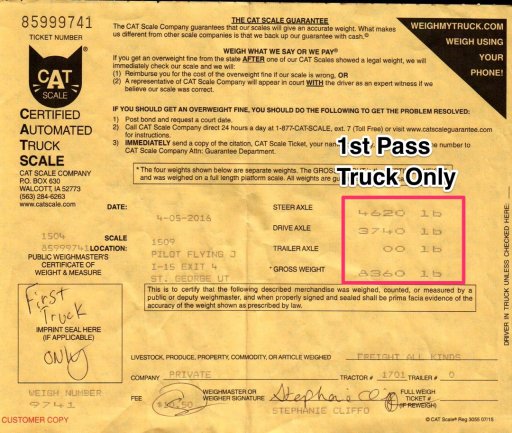

This is my truck with full gas, two adults, 2 kids in car seats, all my tools and gear, generator, 4 water cans empty and two 5.5 gallon gas cans full. We were full time. Should be lighter now.

Yeah you are only about 150 lbs away from being max gross of 8510 if the ram site is correct. Even though we have full size trucks it seems to be really easy to get to max capacity. Are you concerned with the extra weight of the rear bumper / tire carrier / rtt / bed rack? Even losing some weight here and there would barely offset the added gear.
I should be closer to 500lbs less now that I am not living out of my truck. I lived on the road for two years towing the Airstream. A lot of gear I was hauling around. The PW is derated compared to the standard Ram 2500 Hemi which has a GVWR of 10000. Most of us assume this derating is for liability because of soft coils and the factory lift. Axle ratings are the same. Tires have enough. So, I'm not too concerned. I'll see were she is when we get done. I made some changes to our Airstream, so both setups need a trip to the Cat Scales again to dial things in.

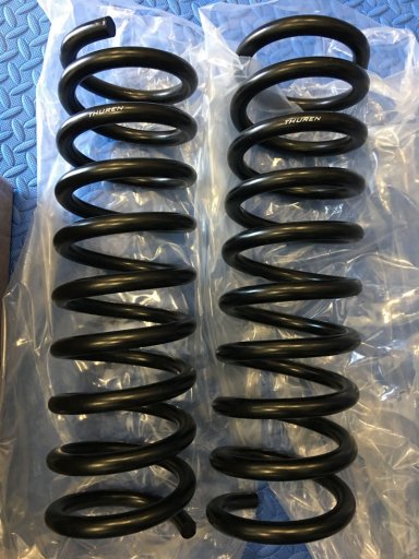

In other news, things have showed up today.

Since you are going w/ the thurens are you going to add some overload air bags with like a daystar cradle in the back to prevent that Corlina squat?
Nope, not yet. I'm doing fronts only, conducting an experiment. Going to see what results just the fronts, with stock rears and King 2.5's get me. Adjust from there.
I've been asking around about various setups and no one seems to have a straight answer. So I'm just going to have to experiment and record the results.

Why does it seem like you and I and a very few select others are the guinea pigs for modding out the newer PW??:sunglasses:
It's funny, Marcus came here to help do this build. And I was just talking to him about how no one really seems to have the exact specs on these springs. They're the same height as the PW springs unloaded, but they're 20% softer according to Don, whatever the hell that means exactly. ¯\_(ツ)_/¯ And we're taking off the sliders and I mentioned, we should measure the fenders to see if the weight of the sliders pulls the truck lower or not. So I am hoping to take a crap ton of measurements and other details and hopefully be as thorough as you were with the gear install.
