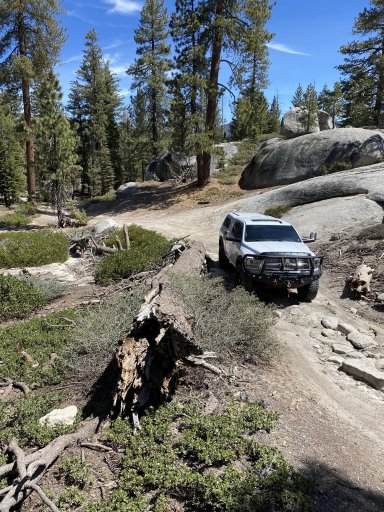

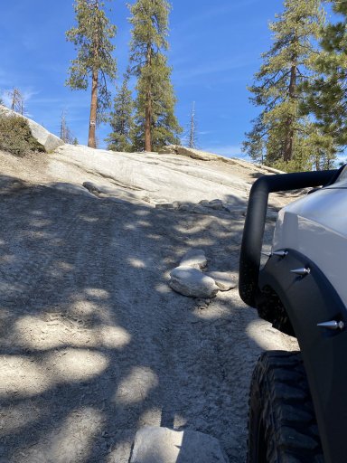

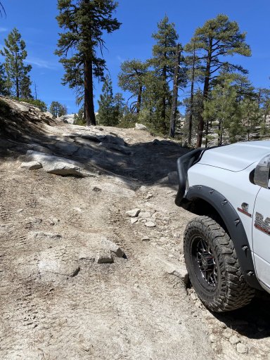

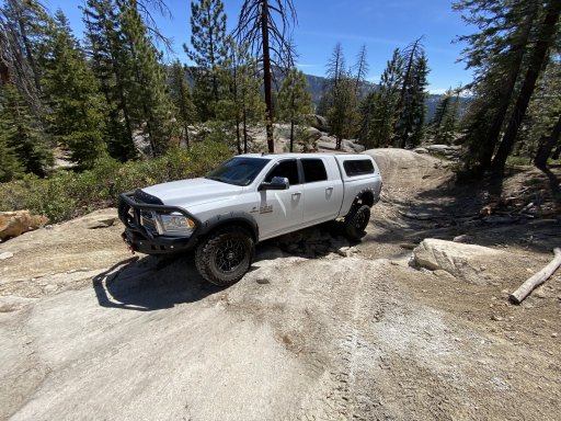

My Baby is "Betsie" She is a 2018 Ram 2500 HD 4x4 Laramie
she came with 20" Hostile wheels on 33" shoes but I cut the pinch welds and used a heat gun to mold the fender and lining back on the front fenders to fit 37" can't even tell anything was done
got her a 2.5 level kit in front
she has air bags in back
did the 50 gal. Titan fuel tank upgrade (wanna go further for longer) I wanna do the 30 gal. spare tire well tank next!!
brand new Snug Top, windoors with slides on the sides, USB outlets at the tail gate, and yakama tracks on top for a future rack, wing awning, and lighting system.
full bed carpet

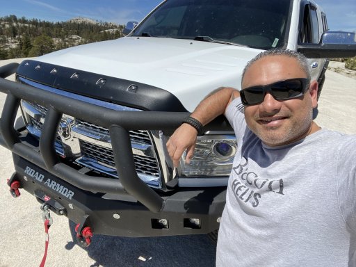

Last but not least, I got her the Road Armor Stealth front bumper with 4 Westin crazy bright LED fogs, and a 12k Warn wench with synthetic rope that will protect my babies grill. Think I have to go bigger on the wench though... (popped the drum rope set bolt tryin to pull her out of deep snow last weekend up at Bald Mt.)

Thank you, now I see what you mean. She's a beast and that front bar is fierce! Hope no one backs into your wheel fender thingys lol. Awesome!

Yeah she is my baby.!!!!.... I REALLY wanted the front end protection!!! nearly EVERYTHING is plastic on cars and trucks these days, so I got what had picture proof of how good these bumpers withstand accidents both vehicular and obstacle...lol... I custom ordered the 1.75" chrome plated aluminum giant tree spikes online.... "not cheap" but it has been something I have been wanting to do to my truck since my first Tacoma years ago when I put the same style fender flares on.... just finally found a company that sold to the general public.

Yeah what ever you can't go around, you could just go straight through lol.
