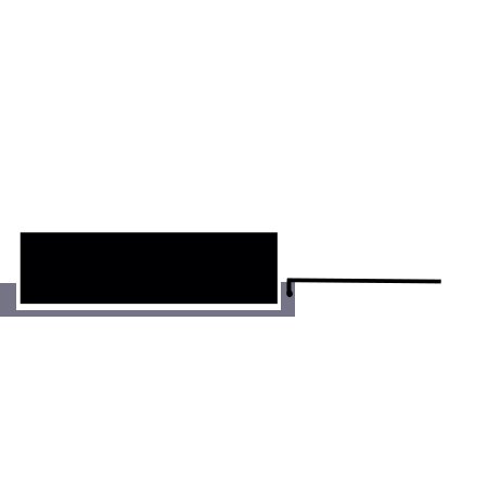

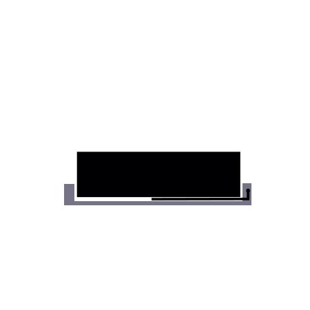

Next up for my build is spit swing spare tire carrier. On one side I will put a ladder and vertical propane tank. On the Other side I will put the spare tire. The challenge that I am having is with my barn doors. To be clear I love the barn doors and went with this age of vehicle specifically for therm. One of the features of the barn doors is you can swing them completely open and a bit past 180. This allows full access into the back of the suburban. I am looking to design a swing out tire carrier that does not impede this feature and not having a lot of luck finding any examples. All of them go 180 which would mean that the doors would open even less than that. I suspect it will mean that I have to extend the bumper (around the corner) and put the spindle on this extended part. But I am just looking for examples of someone who has done this. Anyone out there?tire swing around the corner.jpg

I haven't had to do that but your idea runs along the same line they used on the older S-10 Blazer swing out. The spindle was to the side of the tail light and the carrier cross bars, curved around to the back. This kept the tail light (pass side) from being blocked. It also got the swing out away from the tail gate.
I'm sure your aware of the amount of reinforcing your going to need there. When its open, the weight is going to pull down diagonal. If the center latch on the swing out isn't supported properly, the tire movement will make your spindle move front to back. When you gusset that side wing, make sure you reinforce for both directions.

I agree. That is probably why you don't see it a lot but also why I was hoping to see an example. :) Might have to start googling S-10 Blazer swing out and see If I can find a couple pictures.

I couldn't find a clear picture of what I was referring to. I've owned two of them. The difference was, they were mounted to the body. The tube had a (I think) almost a 90 degree bend as it came around. If you measured how far your rear door opens, you would set your spindle a few inch's behind it and out far enough so the tube wont hit the side of the vehicle when opened.

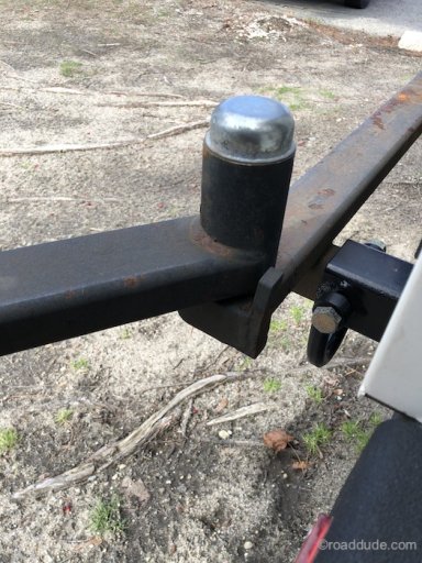

I'll snap some images tomorrow if I remember, of the swing arm tire carrier on my trailer, which stops at 180 only because of a welded-on tab. Otherwise it would swing further and eventually hit the rear fender step on the trailer side.

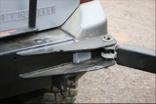

I wonder if something like this might work for you, too:
It's made with Heim Joints, and is from this page at offroadfabnet.com.
Might be something else in that thread, too, that will give you ideas.

Snapped some images for you this morning of the swing-out tire carrier setup on my trailer, for what it's worth in designing something for yourself.
The welded-on tab on the upper arm, in the middle under the diagonal brace, keeps the swing-out from swinging in too far when closed and keeps the two bars parallel.
The welded-on tab at the right end of the lower bar keeps the swing arm from swinging more than 180. If it were not there, the swing arm would easily go as far as allowed, until it hit the right rear fender.
If the tab were modified/relocated, it could be easily made to swing further than 180 but stop where you want.

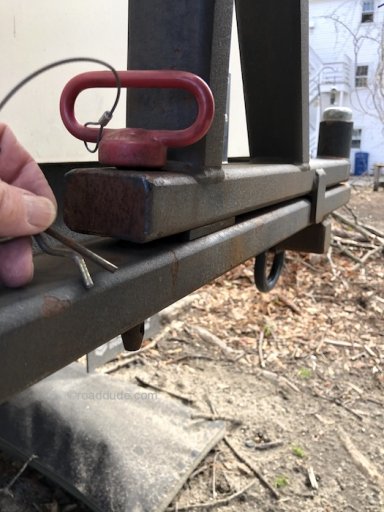

The whole assembly, swing arm bar and lower bar, mounts into two of the three 2" square receivers that are welded to the rear of the trailer frame.
Here are a few other views, including one of it closed with the hitch pin through, which is kept by a simple cotter pin.
Hope these are helpful or give you an idea of what else is possible when you get to doing something for your setup. If you need any other info or images, let me know.
