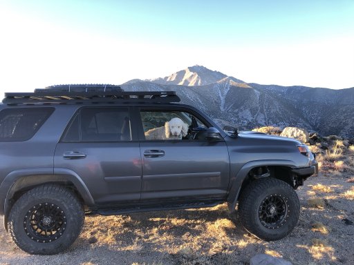

my beautiful 2016 decked out rig has taken a beating out hunting,,, pin stripes galore. what is the best ceramic coating to combat that? is there a better system? mine is defintely not a pavement princess.
anyone with any good experience, which brand? seems like a million out there?IMG_4336.JPEG

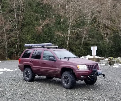

We have not tried the ceramic coating, went the good quality wax route for a while and it did help as long as you applied it regularly but was more ongoing work than I cared to do for not outstanding protection. the paint on our Grand Cherokee got the point where it had seen better days so we sprayed the exterior with color matched Raptor Liner about 4 years ago. fairly easy process in the driveway and around $600 total. It is a commitment and a one way trip as you have to scuff your paint and the two part epoxy is not coming off lol. However after 4 years of hard use on the NW brushy trails it looks as good as it did when we sprayed it, only has a couple of marks from the dogs toenails when she hung out the window. Color matches exactly to the factory paint when you open the doors. for us with an older rig that already had pinstripes etc it was the perfect choice, and gets a lot of comments when we are out.

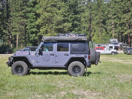

For the JK it was in perfect condition and had never been off road when we purchased it so we did not want to commit to sanding down the paint so we went with the vinyl wrap. So far it has held up well with a few marks but no real damage yet. We are carful to avoid larger broken off branches that could rip the wrap, but have run lots of miles on brushy roads and are happy with its performance. You do have the option to have graphics printed on the wrap where you do not with the bedliner if you desire. A couple of things I would recommend would be to get a small section printed in advance and take it out to your rig in sunlight to check color and match to existing paint if you are not wrapping the entire vehicle also take a picture and/or look at it though sunglasses. The little patch they did for a test looked pretty close to factory paint, but when completed and in the sun was not near as close, and is much more off in photos or with polarizing glasses, likely due to pigments in the printing ink. If we do it again we will go with a standard gray and wrap the entire Jeep. As a bonus the mud and bugs seems to wash off easier from the wrap than the paint.
