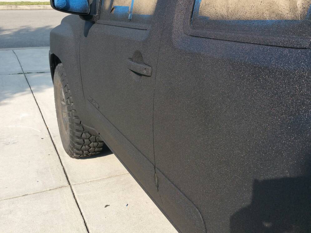

excellent would you recommend for someone that has little autobody experience? Decent at taping but how is it to work with? did you add color? About how much did you buy to cover your whole truck? - Thanks
I've never painted a vehicle before, but spent 10 hours prepping and 2 hours spraying. Be sure to use a compressor recommended for paint spayers. Was super easy to work with. You have to adjust the pressure to get the texture you want. Definitely a diy project. I bought 2 kits that came 8 bottles total, i wantes to have two sprayer guns. I purchased the black kit and did not add color. I like the raptor liner because it has UV protection, after a year there is zero fade. It has a semi gloss finish and if its not dirty sparkles in the sunlight.

Looks like its fairly coarse does it trap dirt?
