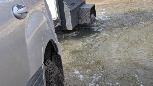

On a recent weekend trip with my new DIY trailer, I encountered several above the hub water crossings. While I know the hub seal is in good shape and my bearings were well packed, I couldn't shake the notion that if water made its way into the hub I would have had no idea and still had to make the 300 mile drive home. On a longer trip I could hit a deep water crossing on day 1 and still need to drive 2,000 more miles until I get home. Since my axle spindle isn't an Ez-Lube or the like, my thought is that a bearing buddy would help keep water out of the hub. A Bearing Buddy would also allow for more grease to be put into the hub, possibly displacing contaminated grease after a series of deep water crossings.
What steps do you take the ensure your trailer hubs stay well lubed and protected on long trips that include deep water crossings other than proper pre/post trip bearing maintenance?
