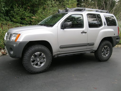

While I miss having the truck bed to carry gear and firewood, this platform is much more capable off road and also is just big enough for me to sleep in. The rear locker has proven itself as a great addition on many trail runs and the heated seats are great for my bad back in cold weather.
Here it is the day I brought it home -

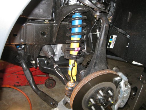

Next came the suspension which was checked over by Greg at PRG after being removed from the totaled truck. The PRG UCAs received new heim joints and the Radflo 2.5" dia shocks got all new seals and fluid. At 1300 miles we pulled the stock suspension parts and swapped in the refurbished parts to get the X up a little. I chose to replace the rear leaf springs with the OME MD leaf pack as I had already found the stock leafs far too soft and prone to bottoming out on the bump stops.
These parts had given me 2.8"s of lift on the Frontier but since the PRO4X suspension is about 1" taller from the factory, they yielded about 1.8" of lift on the new Xterra. I am fine with staying a little lower as the X is a little top heavy and its superior entry and exit angles and shorter wheelbase provide more clearance already.
Here is the suspension install with a shot of the stock front setup and the results for comparison -004.JPG 002.JPG 005.JPG 035.JPG

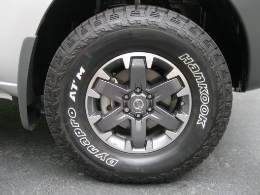

DruTrac's.jpg DuraTrac's 1.jpg DuraTrac's 2.jpg 285's.JPG Next came a little height in the form of some 285/75-16 Goodyear DuraTrac's in load range E. While the Hankook Dynapro ATm's are very good tires, I wanted to upsize and when I got my local tire shop to match Discount Tire's sale price, I just couldn't pass up the deal! The larger size required a minor modification to the pinch weld at the bottom of the fender and a little work on the fender liner with a heat gun. In the Nissan world this is referred to as the 'Melt Mod'.

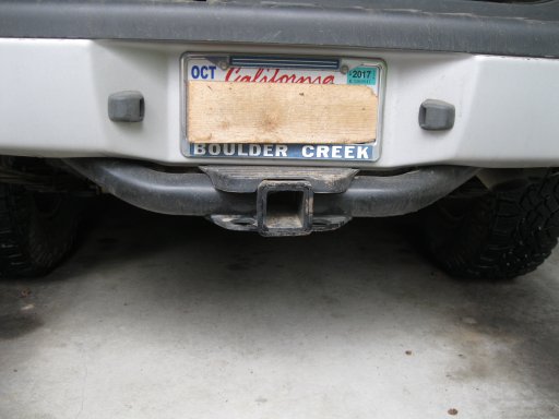

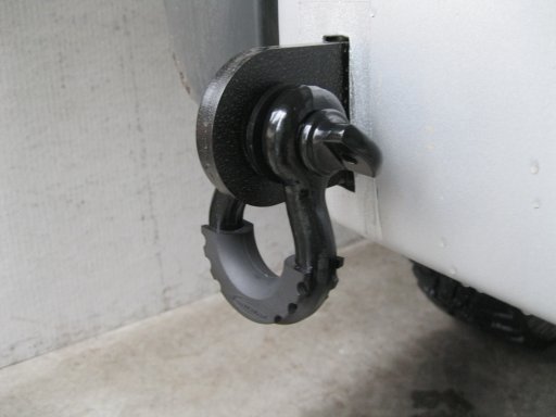

I wheeled the rig like this for about 1 year and while it performed very well on the trail, there were a couple shortcomings that kept popping up. The trailer hitch was the limiting factor on exit and was becoming a problem as I attempted harder terrain. I had left it on because it was my rear recovery point. You can see how far down the hitch sits in the 1st photo. I solved that issue by installing Habitat Offroads rear recovery points and a pair of shackles.

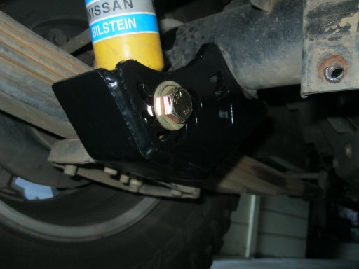

The rear lower shock mounts on the Xterra hang down and are vulnerable to rock damage. Mine had already taken some hits and sustained some minor damage. I decided to buy the bolt on skids that NissTec offers since they were on sale for about $100. The install is relatively simple and now they're protected.
