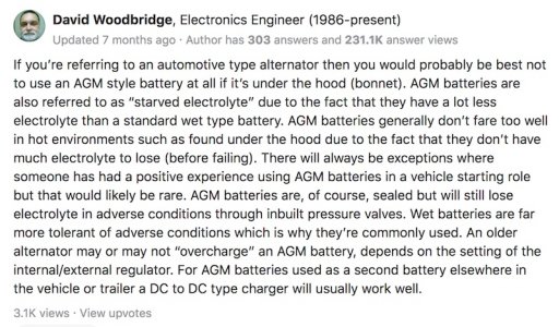

AGM question...I saw on here or somewhere recently that most alternators don't fully charge an AGM battery. So, I hooked up my semi-smart charger with an AGM setting on my fairly new AGM battery and sure enough it was only holding about 80% charge. After charging and sitting for a day it was still holding 95% or so. Is it correct that the alternator on my '17 Tacoma is not fully charging the AGM?? How often should I "top it off"?
Though I love my pair of Odyssey AGM in my trailer (charged only by solar through a solar charge controller), I won't put AGMs in as cranking battery(s), at least in my 2008 GMC diesel with an older 140amp alt.
Like anything else with vehicles, you'll find all kinds of guys that will swear by using AGMs with regular alternators that say "I've been doing it for years with no problem and never had to charge them!" I'll bet their AGMs were not appropriately charged and did not last as long as they should have, and I bet they didn't even know they were shortening their battery's life.
Same with mixing batteries of different types, or even different ages or sizes of the same type, in a dual-battery set up with just an isolator between. With a proper DC-DC charger, yes, because they do not "combine" the two batteries but keep them separate and send the charge from the cranking batt to the house batt when appropriate. I explain it more in post #7 here, in the Super Simple Dual Battery Project, which also includes a link to a great Optima article on the subject.
Back to AGMs in cranking positions: In my own research I've found wildly contradictory info; even on battery mfg pages. Some say AGMs do not get enough voltage from alternators to properly maintain a charge and that regularly being 15-20% under-charged will shorten their life. Others say they get too high a voltage from alternators so have a shortened life because of that. Some even show conflicting charts on what voltage AGMs should get and what alternators typically put out.
Some of the conflicting info is, no doubt, to the age of the article, the understanding--or lack of--the poster, and the fact that battery and alternator technology has advanced, rendering some older info obsolete. Though it still is all over the 'net, confusing folks and conflating facts.

IF I was to put and keep an AGM under the hood, I'd be checking it more often and hooking it up more regularly to a smart charger.
