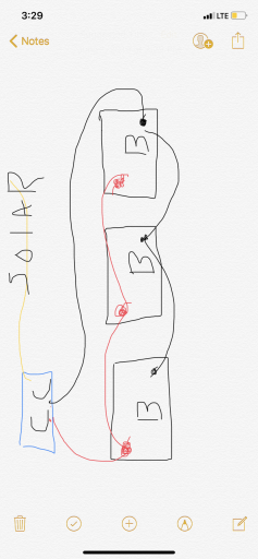

Yes this will give you equal charge and discharge through the batteries. It will act as one very big 12v battery. This configuration will keep the source voltage at 12 but will add the ah capacity of all three batteries. So if the batteries are 100ah each you will have a 300ah 12v battery.Ok I have been looking around and trying to get a clear idea on this. I’ll get pictures when I can. Is this the proper wire set up I have done to my batteries to get equal discharge and charge out of my 3 aux batteries
