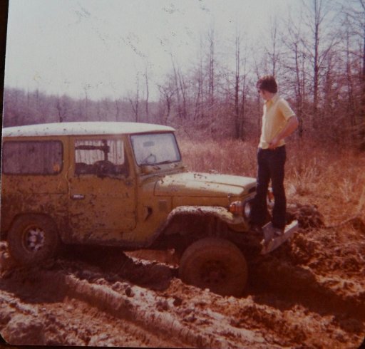

Nice write up. When I was coming up there just wasn't any information at all other than a few OSHA handbooks for rigging, so I relied on my wit, and fell back on my farming backround to get out of trouble. It is amazing what a simple shovel, a stock bottle jack and a bit of labor can get you out of. The school of hard knocks taught me a lot along the way. Today I carry a bag of stuff along with a winch, high-lift, bottle jack and 2 shovels. A lot of the extraction equipment we have today is a really nice convenience. Here I am circa 1977, learning about open diffs, bottle jacks and shovels. DSC01093.jpg

Nice write up. When I was coming up there just wasn't any information at all other than a few OSHA handbooks for rigging, so I relied on my wit, and fell back on my farming backround to get out of trouble. It is amazing what a simple shovel, a stock bottle jack and a bit of labor can get you out of. The school of hard knocks taught me a lot along the way. Today I carry a bag of stuff along with a winch, high-lift, bottle jack and 2 shovels. A lot of the extraction equipment we have today is a really nice convenience. Here I am circa 1977, learning about open diffs, bottle jacks and shovels. View attachment 70252
I really love the roots LC FJ 40 series. I've learned to drive on my father's FJ 40. It's an awesome rig!!!
