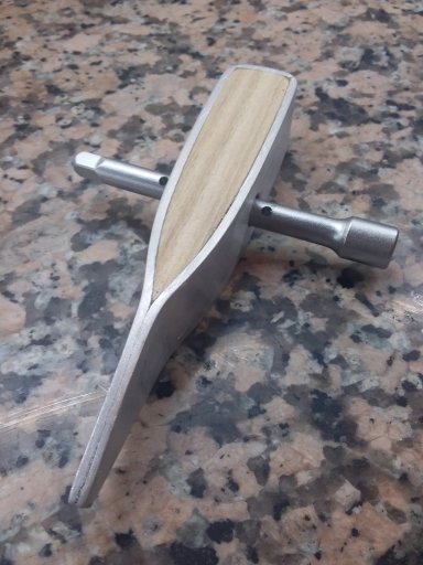

Try this video of a simply made tool - it shows how to used bailing wire as really strong clamps. I made the tool after watching the video and it is now in my trail kit.
THAT is one awesome tool. The wire clamps it helps create are just about as awesome, too, with their regular banding and pressure.
I'd love to see the one you made, too.

Mountain Spirit Overland
Dubai United Arab Emirates
Simon
Alderson
22305
Stay safe, stay clean, stay healthy!
Here's the one I made, but with an 1/4" extension bar with a couple holes in it to tension the wire.

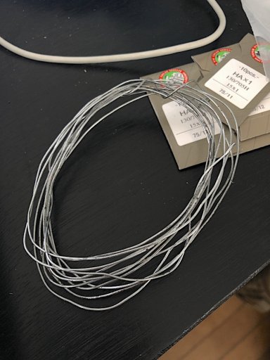

I keep a small coil of finer gauge around all the time, both in my vehicle and on the workbench. In fact, in looking for wire I can use for the nose bridge on face masks I'm making for health care workers, I have some on my desk right now. So, I was surprised to see this thread pop up!

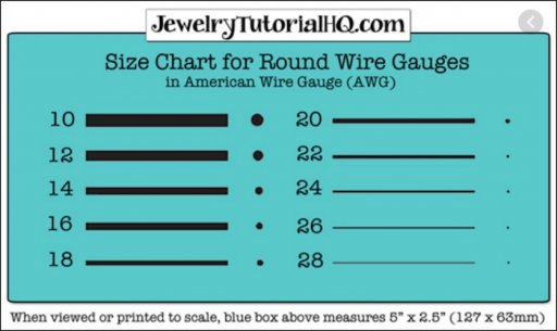

If looking for it online you may have better luck searching for "baler wire." Remember the bigger the number, the smaller the wire gauge. 16 is thinner than 14, for example.

I keep some of this around all the time, too, for a variety of uses and projects: Green Garden Wire 22ga.
