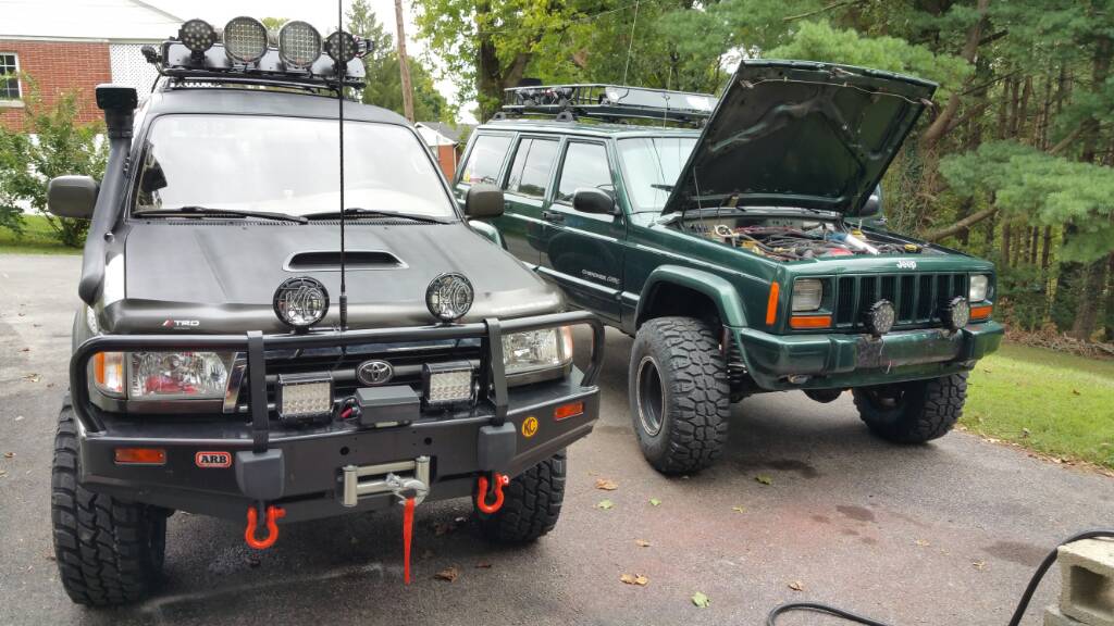

Got my 12K tucked in my bumper. I had to flip the springs and clock it to get clearance. Way more winch than the 4arunner needs so I never have to work it at max capacity.
