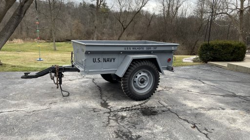

I took a trip out west with some friends of ours a 1.5 years ago and they made a overland trailer from a 416 and that got my wheels turning. 1.5 years later I picked up this M416 and I am going to start a build.
I plan to post pictures as well as my videos of the journey!
I have a lots of thoughts/plans for it such as:

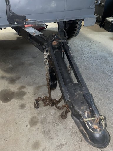

  1. a receiver hitch on the back
  2. extend the tongue

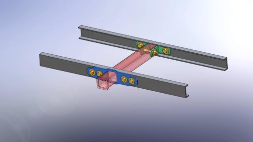

Part 1 is done! I needed a hitch to take our bikes with us. They don't exactly make a good kit for something like this. Decided to make my own. I did a quick 3D CAD model to visualize and tweak things before I started cutting metal which helped.
I used a company called SendCutSend to laser out the rear bracket. It was cheap and quick and turned out perfect. The front bracket I used some angle steel by buddy had that I cut two pieces from. I used 5/8", grade 8 plated fasteners which might of been a touch overkill....but why not...until it was time to drill out those big holes which took some time and lots of patience.
It came out nice and I'm real happy with how it turned out.
