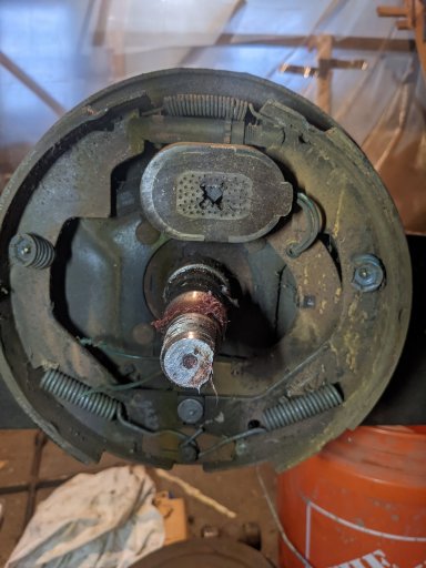

I have run into a dilemma. I stripped down a free popup camper and cut down the frame to just over 4.5 x 6ft. It has a 30 year old Dexter rubber torsion axle, and talking with some folks it might not be useable anymore.
So I'm down to a decision between buying a 3500lb axle kit and mounting it on this frame, or looking for a used Tractor Supply trailer or something similar. My concern is the axle rating. Most of those trailers have a 2000 or 2200lb axle rating. Is that enough for a small 5x8ish RTT camper? We'll have about 700-800lbs of tent, people, and metal framing before any gear gets loaded, and we'll probably have bikes and typical camping gear. We do try to pack light though.
Either way I go I'll repack bearings and get new tires, so those factors aren't a concern.
I've attached a photo of my current situation. I'd hate to get rid of the trailer frame I have if I can find a matching axle, it's a really sturdy steel frame.PXL_20220118_220016458.jpg

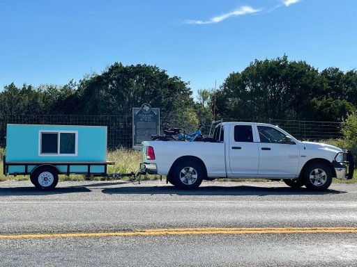

Torsion are cool and have applications where they cannot be beat, but I prefer regular axles on leaf springs because I can isolate variables more easily. A light weight trailer can easily be built with light suspension on a heavy duty 1 ton truck axle from a junk yard, you won’t get the same results putting a light trailer on a heavy duty torsion.
The heavier duty suspension means your gear will take more of a beating, especially if the tires are over inflated or not balanced or you are going over rough terrain. The weight of occupants isn’t relevant in my opinion because stabilizers or jacks will eliminate the static weight bearing part of the discussion. Your math needs to be oriented towards fully loaded going down the road to decide on suspension.
I’m of the school of thought that I want the trailer as light as I can get it. Keep the trailer light and the light axle won’t be a problem. Our camper started as a 5x8 TSC utility trailer that I built a 4x5x8 slide in camper box. The downside is it came with an angled 2k axle so I can’t flip it to be under the leaf springs without getting out the welder, which I’ll be doing soon. A benefit is that I can move this trailer by hand to reposition. Two people can roll it around and the truck doesn’t even notice it back there compared to the weight we often have in the bed. We’ve also thrashed little trailers like these and they do surprisingly well, but go heavier duty metal if you know you’ll be shaking it hard on trails. We don’t go wheeling in the camper and truck, that’s what the bikes are for.
