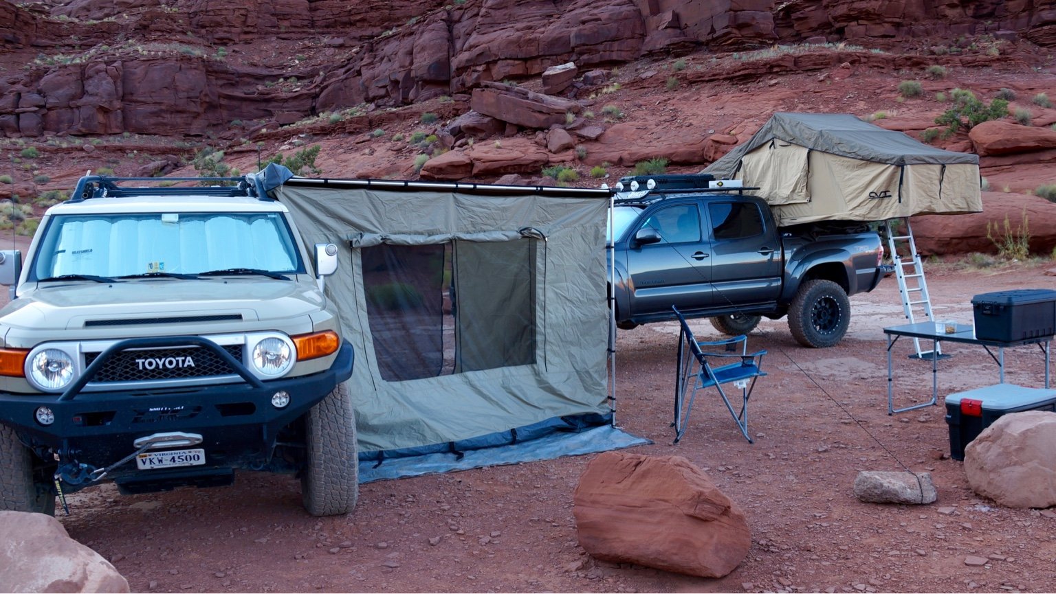

I use my ARB Awning Room as our main tent all the time (Cant fit a RTT tent in my garage). Spent at least 30 nights camping in it in the deserts and mountains of CA, AZ, UT, OR, WA and British Columbia. There were only two nights I had to sleep in the truck because of winds being too strong (30-40mph). It has held up fine!
Same. The ARB room is my main tent. The wind tends to push in and is noisy. I’m also unable to open or close windows from the inside. I set storage bins around the base of the tent to hold back the sides and move the cot to the center. I am set up to sleep on a platform inside the FJ if very bad weather is forecast.

I'm considering adding a good roof rack + RTT or just a good ground tent in place of the ARB room for sleeping. The ARB awning room is great for a rainy day and as a hangout. It gets very hot inside during the summer; I would try to get it packed up early in the morning. Not safe enough for me in high winds.
