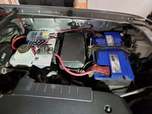

Here's what I went with. Made it a breeze to wire anything. Just make sure you've got everything fused up. It's not wireless but I think this will be way more trouble free. I've got a set of rigid pods in it, a pair of lightforce lights, among other things.

Yep, pros and cons to everything. I went with price and reliability. I've tapped some holes in my inner fender to mount the relays just haven't actually put them in yet.

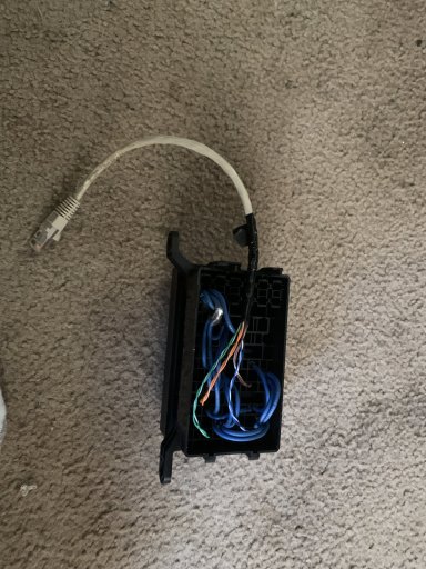

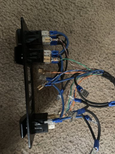

So a relay’s purpose is to take a low amp input and turn it into a high amp output. The LEDs in the rocker switches draw less than an amp with all of them turned on, so no need for anything more than 22 gauge wire to feed the relay trigger. A Cat6 cable has 8 30 gauge wires, so I paired them up to make 4 wires. I always feed my switches to the ground side of the relay trigger when I can, this means all I need is a single ground wire running from a common ground and a small capacity wire to run the positive side for the led lights.
this is going to allow for easy expansion in the future as well as keeping the spaghetti mess minimal.
Thats awesome! I have never thought of this before!

I hadn’t either. I tried searching the internet for someone doing this before, and if it has been, the process hasn’t been documented. Once I get all the parts located, I will be doing a whole documentary on it as part of my build thread.
