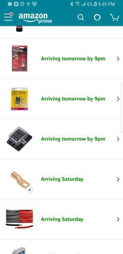

I'm going with 6 guage copper automotive wire with a bussman type-1 30amp fuse which I'll mount in the engine compartment and run through the firewall to the fuse box behind the radio. From fuse box, I'll install fuses based on wire size and application.
