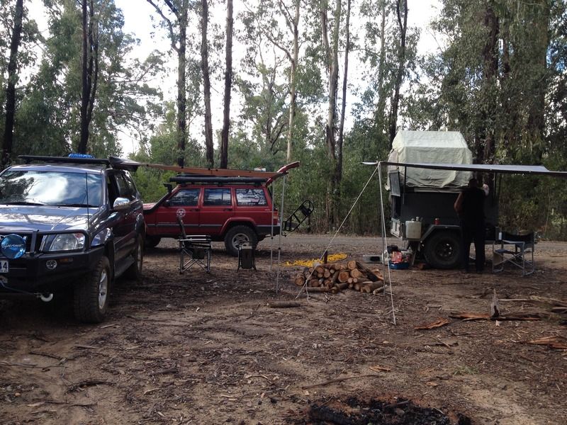

Went away with a couple of mates over the Labour day weekend, the plan was to make our way from Big river to Buller
An engine bay fire in the Jeep just about stopped us in our tracks, we were on Mitchells track just out of Jamieson and attempted to drag it back out to the main road, but couldn't get it up the last hill
We made the best of a bad situation and emptied the contents of the Jeep into the 2 mobile cars we had and left it on the side of the track. Made up camp at Howqua and drove into Yea to get parts to fix it.
Made our way back to the car the next morning, replaced some parts and got it running, drove it back to the campsite and had breakfast.

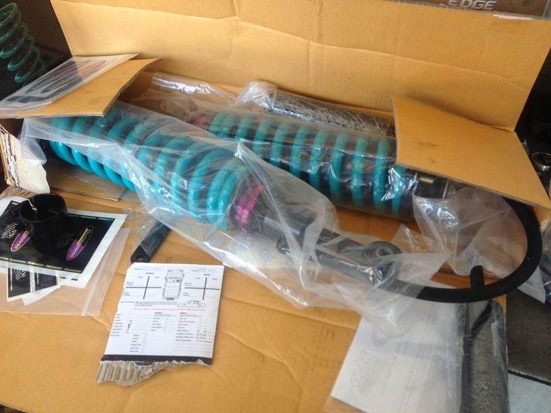

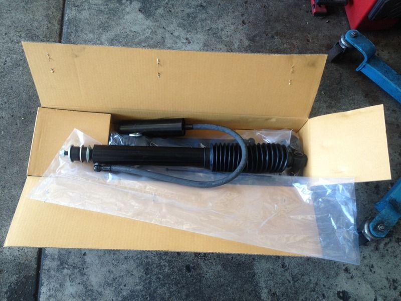

2017 I replaced suspension
It's suspension time, the ironman stuff had seen its day with the extra weight I had added up front
Dobinson remote reservoirs, dobinson coils, 100-300kg constant load in the back and adjustable upper control arms for the front,
This should make it better with my camper on the back as well as let me actually adjust the alignment properly, my tyres which are 23,000kms old are wearing super uneven and started howling, fitting day is tomorrow
Fitted the new suspension over the weekend
Started with the front
I mounted the remote reservoir inside the bulbar bash plate
I have since added P clips to route the reservoir line
Then went to the rear
And mounted the reservoir on the chassis rail in the rear wheel arch
I need to extend the rear sway bar links now, but is a marked improvement on the Ironman lift that it replaced

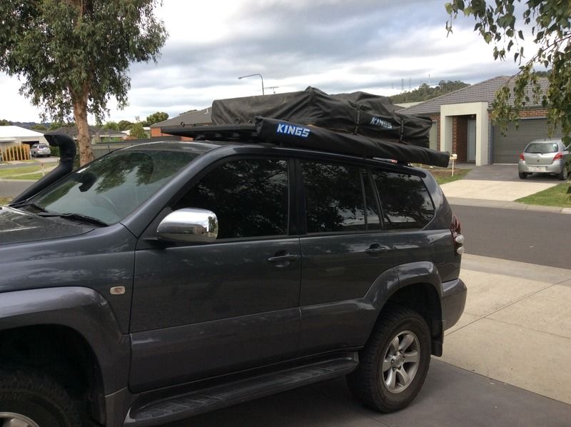

In preparation for going away over the long weekend, I fitted my rooftop tent to the Rhino platform, I was trying to find a way to do it without drilling holes but after nearly a whole day trying to get my head around it I buckled and drilled 4 holes. I won't be leaving the tent there permanently, the V6 drinks enough as it is!!
So went away, Started in Marysville, camped at big river, found 15 mile hut, made our way to Matlock then cut back to Knockwood for the second night, then made our way to Eildon and camped there the last night meeting up with another group

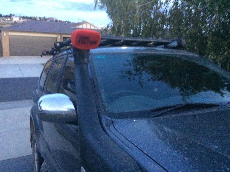

After the trip with all the dust around I decided to buy a Unifilter to go on the snorkel head, hopefully that might cut down on dust a little entering the intake
