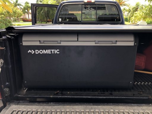

I'm gonna be doing a few months on the road with my dometic under a not-really-weatherproof bed cover. When it was new it kept the rain out, but it leaks between each panel now, so I am buying the smallest tarp I can find and just laying it over it to keep any water from dripping directly onto the power/fan area. I figure that is the only area I really have to be careful about, otherwise, I am not too worried about it. I have to say, it's going to make the trip SO MUCH BETTER! and I splurged with 6mo no interest and got the 95DZ, I'm so excited!! hahaha
