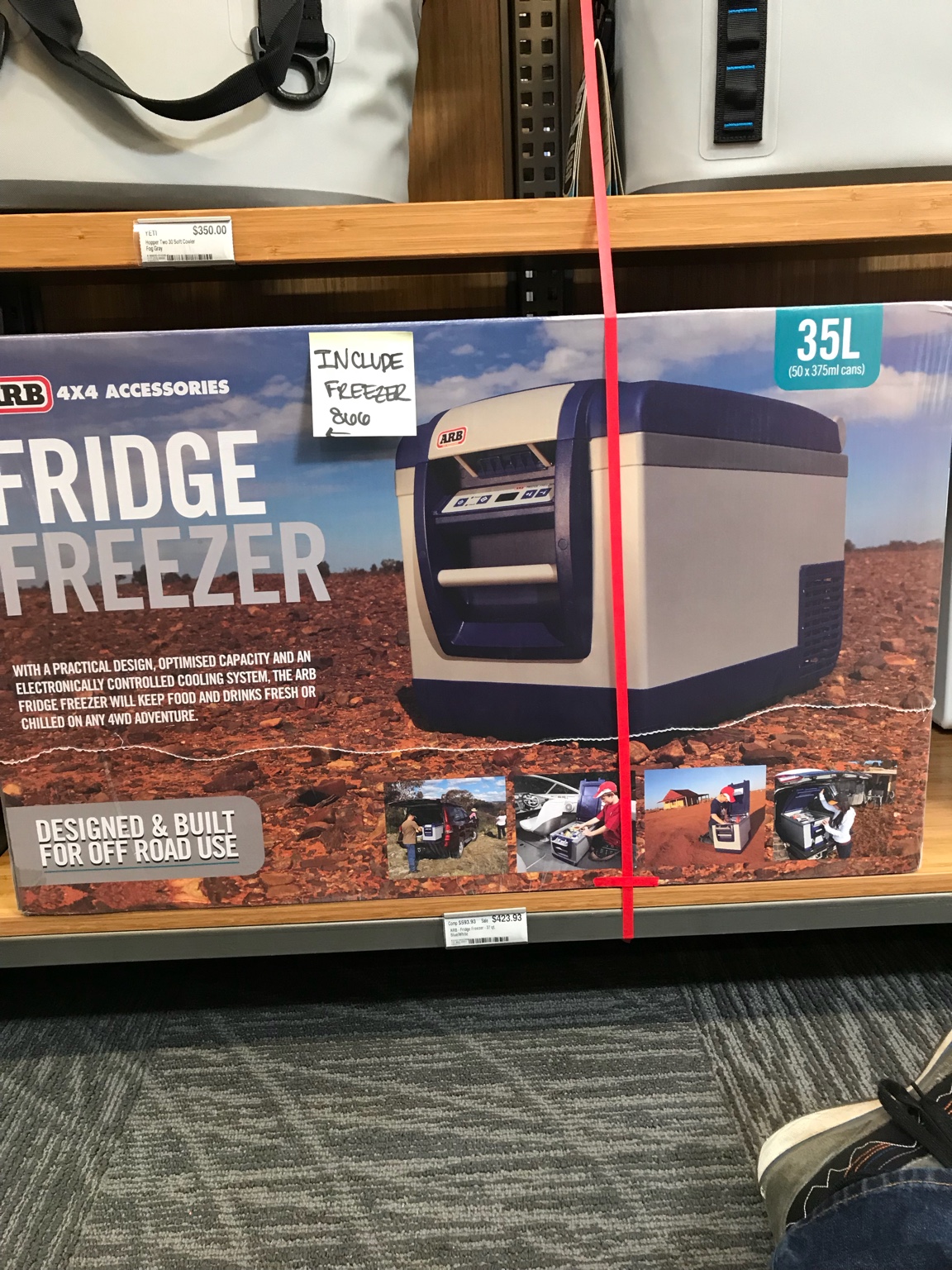

I got a great deal on a 37qt fridge freezer today at the REI in Jacksonville, FL. MSRP on this unit is $849, but I picked one up for $423.97 today. Not sure why it was marked down so far but I am stoked. I will follow up here as I use it more.

Great find!
