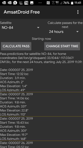

How do you know when a satellite is going to fly over? Welll... that can be a bit tricky as without cell service you won't be able to use a satellite tracking app. (AmsatDroid works offline, per BagiMT below)
However, using sites like amsat.org you can view the pass predictions for the various satellites and note the time of the best passes.

If I was planning on staying in the Ouachita National Forest in Oklahoma on 7/27/2019 here are my available passes that I might be able to hit. There are MANY more passes but I picked out the higher elevation passes that I could hit with my mobile or possibly with a yagi. Yellow are good high passes, Orange are lower passes and white are really low. Orange may need a yagi, white would most definitely need a yagi.

Example: The AiSat-1 pass @ 10:49am with an AOS Azimuth of 25°
I should start hearing packets from the sat just after 10:49, the sat would be coming from the North, slightly NE (25°).
At the max elevation of 26° the sat would be above the eastern horizon and at LOS it would be at 169°, almost directly south.
Example 2: The ISS pass @ 5:58pm with an AOS Azimuth of 229°
I would start hearing packets from the sat just after 5:58, the sat would be coming from the SW.
At the max elevation of 80° the sat would be passing almost right over me slightly to the NW.
At LOS the sat would be to the NE.
