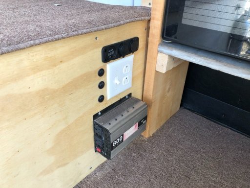

I have questions... my crimping supplies showed up today. Supposed to be hit with a Nor'easter the next few days so I'm thinking of get some stuff ready in the house while riding out the storm. I have a 150A surge\80A constant isolator kit with 4GA primary wires between the isolator and the batteries (HA!! My alternator is 70A, lol). I got a heavy lug crimper tool that can do up to 0GA so I've got that covered, but then I realized I'm not sure how I should cut the cables? Definitely not gonna get done with a pair of dikes or linesman pliers :). We carry bolt cutters on our ambulances, I could borrow one to cut it but those really are more "mash it until it succumbs" vs "cutting," awesome in a get-it-done-NOW situation but not the most elegant. Would a grinder with a cutoff wheel be just as good?
The kit says to tap into the ignition but I'm thinking the alt light wire would be a better option as it would only connect them when the alternator is putting out juice instead of combining them as soon as I turn the key? This is how the Westfalia-installed relays were wired up. Yes? No? I can jump from battery to battery if I need to in a no-start, dead main battery situation. On that, I assume since the two batteries will both be grounded to the chassis, that if I need to do that for a no-start situation, I would only need to jump positive-->positive and not both poles?
The kit has 20' of the 4GA, I'm only going to need about 5' to combine the batteries. I have a fuse panel I'm going to install under the sleep platform. I was going to use 10GA (have 100' of red and black) from the house battery to the panel, but would it make sense to use the 4GA since I have it, even if I don't anticipate much draw? I plan on connecting LED interior lighting, the 100w lights up front, a Coleman cooler, small water pump, and a few 12v outlets for small electronics to the house battery through the fuse panel. I do have a 1500w inverter that will be wired separately direct to the house battery, I've calculated that 10GA would be ok if I keep the run under 4', which I plan on mounting about 18" from the battery, so within the "safe" rating for the max 60A draw. Should I use the 4GA for that too to be safe? Thanks to anyone who replies!

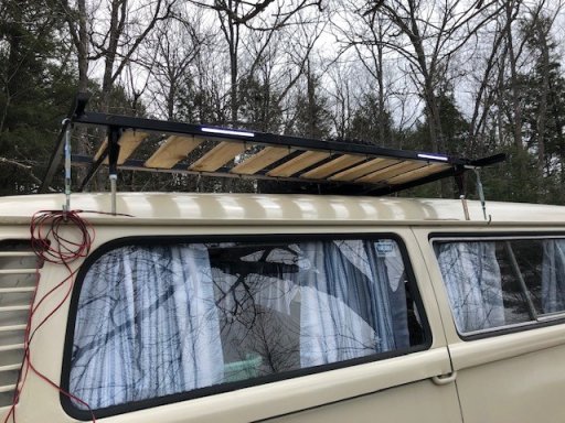

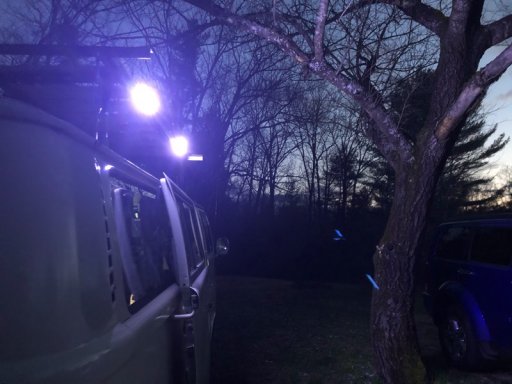

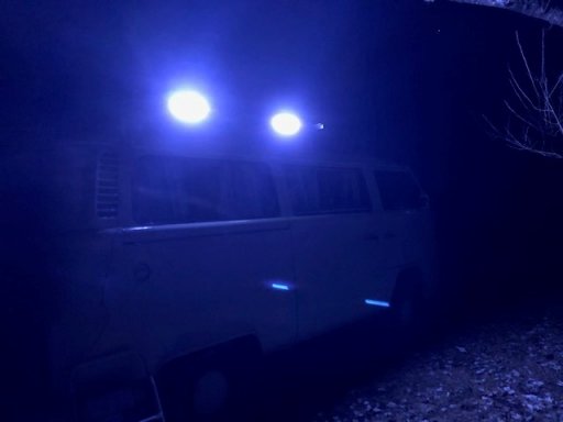

. Not really stealth but I think inconspicuous enough that won’t detract too much visually when turned off. Still planning on a few flood lights on the corners for after dark excursions with more white light and better reach. Think these little ones will do ok for camp lighting. Have on both sides, wired to be able to be switched on side or side or both. Supposed to pour all week, got my projects all in a list so can knock stuff off as time and weather permit.

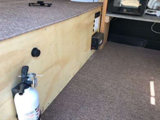

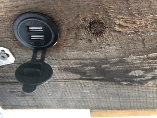

Mounted inverter, some outlets from house battery, switches for interior lighting, and switch/outlet for shore power. Mounted auxiliary fuse panel on the backside of that panel and ran feed back to engine bay. Waiting for a new multimeter/dwell tach so I can dive into getting the house wired up in earnest.

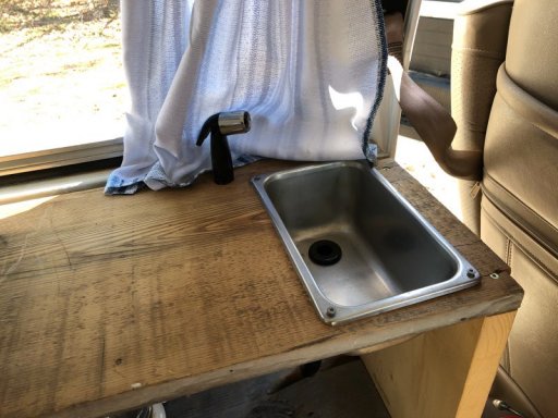

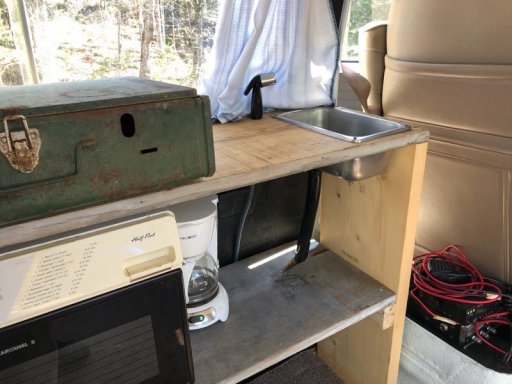

Installed sink (modified chaffing dish) and sprayer.
Cut n storage doors with magnetic latches

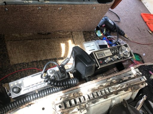

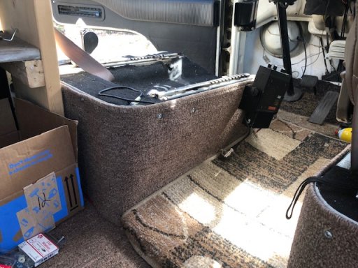

Has a little time today to do stuff so carpeted pedestals, hooked up 2m radio, ran out of time to do CB :(

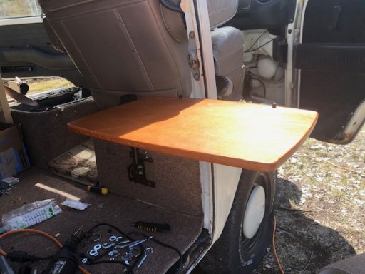

repurposed laptop table

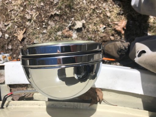

finallygot grommets to wrap up exterior lighting

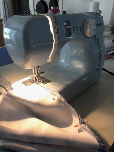

Thanks, guys. I’m having fun and starting to get excited with progress. Not much done today, too many calls. Got one kick panel restored and some more curtains sewn up. Do not fear the sewing machine, it’s a tool and even has an accelerator :).

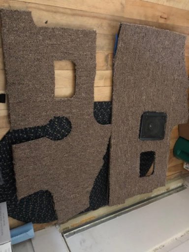

Welp, the "refresh" I did on the kick panels elicited a "what the hell, those are ugly as sin and don't match anything. Are you seriously going to put that in there?" from the better half. Oops. I guess she isn't into OG
Very Happy
. So, today had a break between meetings and cut up the leftover carpet I have to fit the factory panels. The fiberboard is surprisingly in good shape, just ugly. Waiting for a can of 3m 90 and some binding for the edges to show up so can finish them up. Yes, the passenger side one is modified to fit around a few accessories. unnamed.jpg

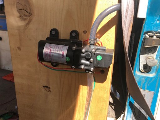

sink pump mounted and wired up.

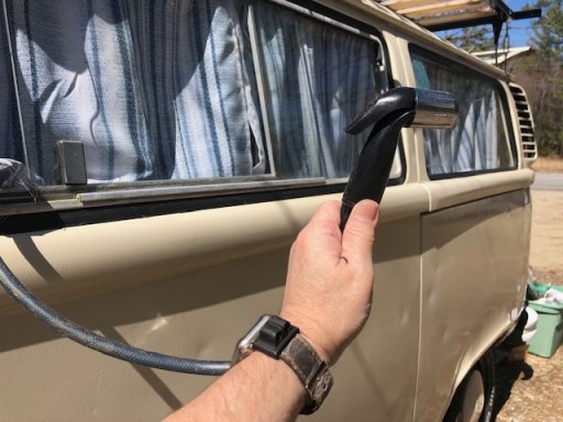

what I like is the sprayer can reach out the window
CB installed, same vintage as the bus :)

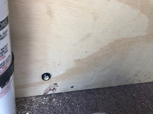

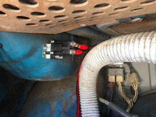

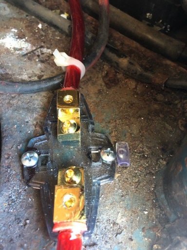

battery isolator installed, but not thrilled with the fuse blocks. Rather small set screw to clamp the cable. Have some concern about how well they will stay put. Thought about safety wiring them but think leaving the the system disconnected until I source better ones is a smarter move.

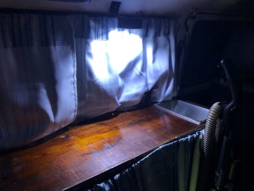

made a kitchen light out of scraps and a 25 cent LED

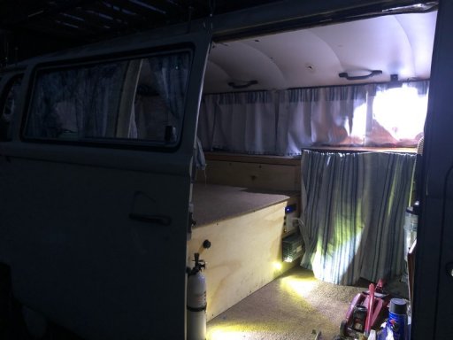

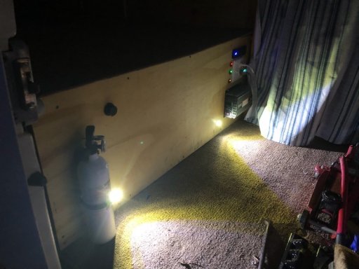

Added some floor lighting below the bed

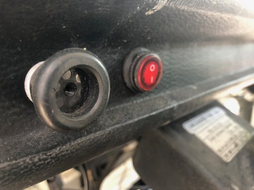

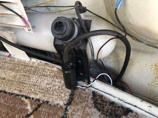

Lastly, wired and plumbed a real washer pump, using a momentary switch on the dash and the OEM reservoir. The VW method was to pressurize the tank with 15lbs compressed air from a tire pump, the “switch” was just a hose run up the steering column that the wiper stalk clamped shut when released. Yeh, I’m serious.

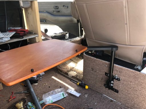

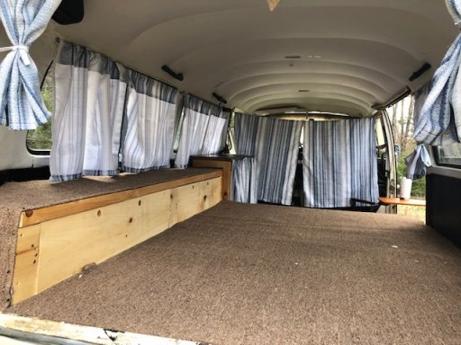

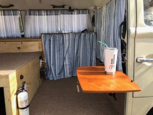

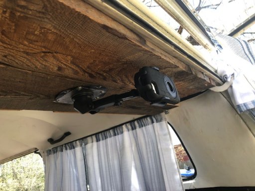

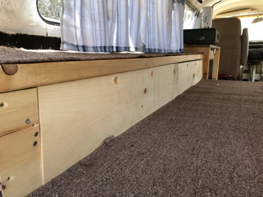

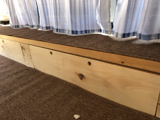

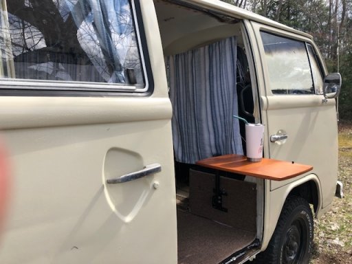

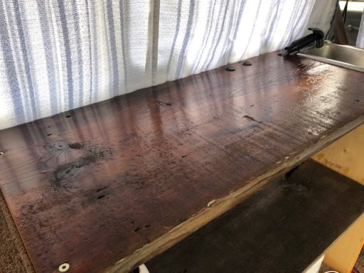

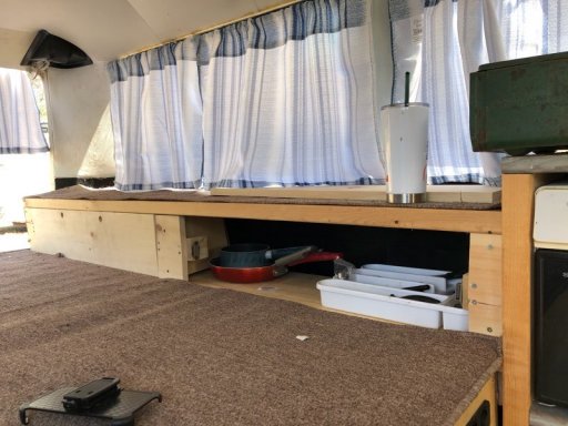

Took advantage of the nice weather to finish up this phase of the interior so I can move on back to mechanicals now that the ground is dry and solid. Hit the counter with poly. It’s old barn board taken from 19th building we tore down in the back yard a few years ago because of insurance reasons. Soaked up the first 4 coats hard before it finally took a gloss, love the color. Hit the new wood too.

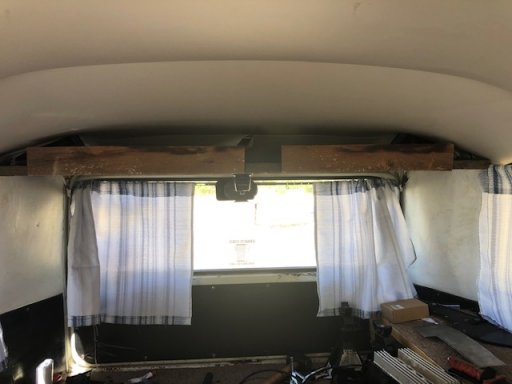

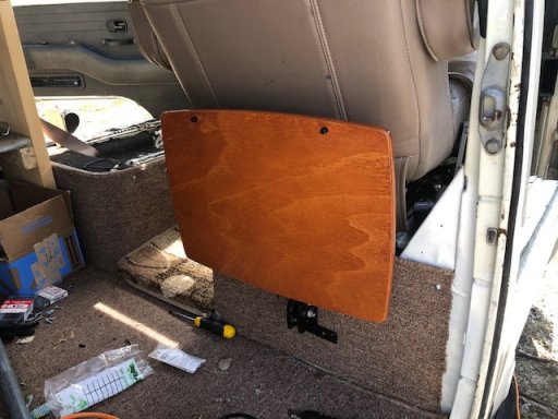

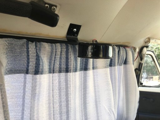

Got the curtains wrapped up. Privacy ones come down and store under passenger seat. I love my little table:)

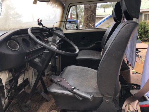

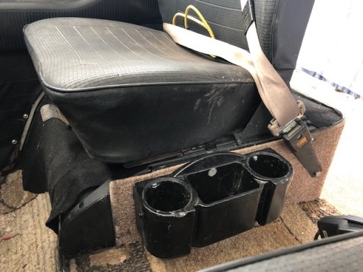

put the stock seats back in, the others were stupid comfy but made reaching the pedals with my stubby legs a chore. Plus,they just feel right, cup holder mounted, too.

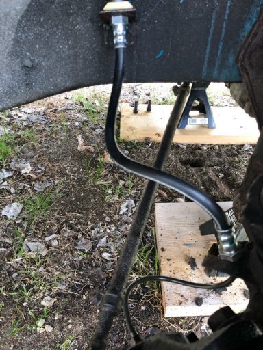

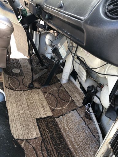

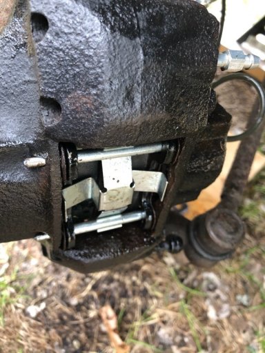

pulled the right front tire old school with spoons, cleaned up the rim to fix a slow bead leak, then rebuilt front calipers, replaced soft and hard lines. Yay, can stop! Not that a bus goes fast but it does have some inertia :).
still haven’t gotten a house battery but the better half wanted see how the new lights look so grabbed the PS from my ham base and hooked it up to the house circuit. We both were pleased. Win!

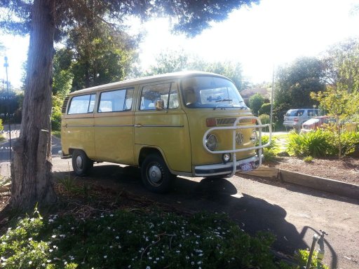

Nice bus, I want a roo bar ! Love the deluxe trim on your bus, looks good with that color

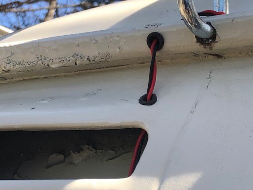

So today was GORGEOUS out. Supposed to mow the lawn but somehow got sidetracked :). Got a few more things knocked out.

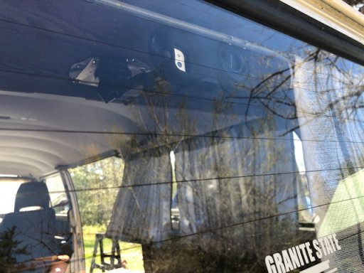

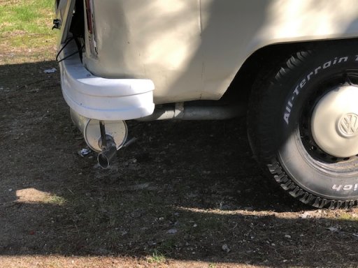

Finally got my Renology fuses for my battery isolator setup so got those I and the rest of the wiring done for the house system and charging. muffler replaced, has to sound better than the blown out glass pack

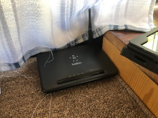

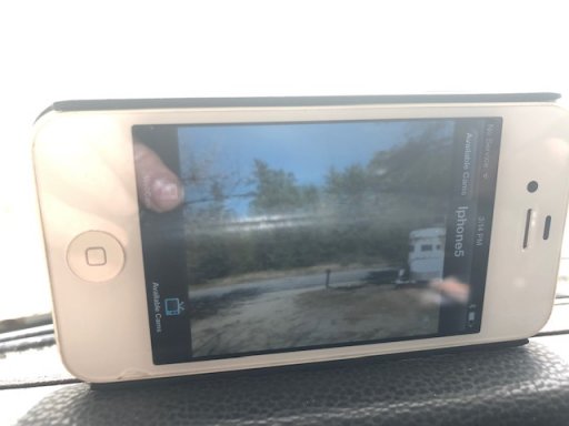

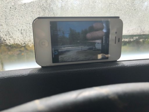

Wired up an old router, mounted an old iPhone 5se off the head banger, ossed a even older 4s on the dash, both loaded up with WebCam+. Now I have a backup cam, total cost $3.99 for the extra mount. The analog bus is now digital :).
Running off local (in bus) WiFi, there’s almost no lag, clarity is decent. Will have to see how it works at night when the backup lights are on. Going to add some LED floods in the back so should be ok. If nothing else, it was fun to do.
