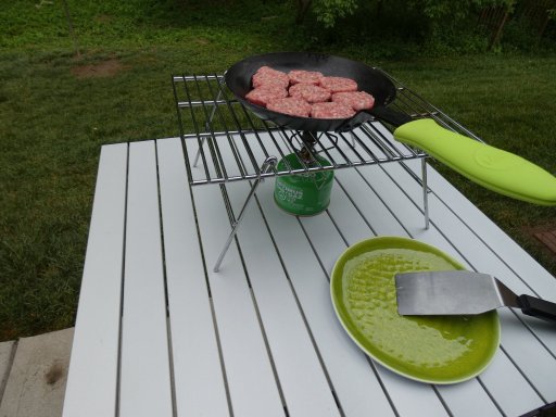

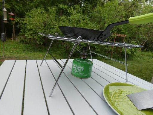

This is my light and compact solution to a camp stove. I have all kinds of dual fuel, white gas, propane, single and double burner stoves. They all take up a ton of room and are a mess to clean up. I end up using half a roll of paper towels every time I cook. I decided to trim this lodge brand fire grate to fit in the action packer we use for kitchen stuff. I also trimmed the legs to match the height of my snowpeak gigapower stove. I have two of these stoves so it would be easy to use them both under a griddle if I wanted. I like having the option to use the grate over a fire as a back up too. This packs away to practically nothing, its easy to clean up and gives me options on a heat source for cooking. I will trim some flat aluminum sheets and put hooks on them to use as a wind block if necessary. Im sure its not for everyone but it works great for us. Its a lot simpler than a microwave and inverter.
looks like a cool set up,, i want to camp with you!!! ,did the metal rack for your pan just happen to be the correct height for your back packing stove?
i have a jet boil stove for backpacking,,,it just boils water to pour into those dehydrated meal bags (like mountain house) i don't think it would do what your set up does.
oops just read that you modded an old fire grate to fit,,,, brilliant! and you can have a 2 burner stove if you want.

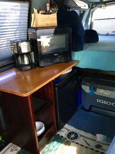

A microwave uses twice the input power than the rated output. So for example: if you have a 600w microwave it takes 1200w input to run it, 1000w microwave...2000w to run it. Read the label on the microwave and find out the Ampere draw that’s the important number. We have a small Whirlpool 600w unit and run a 2000w puresine wave/ 2 group 31 AGMs. We only use it to reheat meals, popcorn, premade meals, not for long term cooking. When I turn it on the meter spins big time, you can literally watch the voltmeter drop like a rock. Love it!CDAD17E8-110A-4924-8D38-B8134AFB34B0.jpeg

A microwave uses twice the input power than the rated output. So for example: if you have a 600w microwave it takes 1200w input to run it, 1000w microwave...2000w to run it. Read the label on the microwave and find out the Ampere draw that’s the important number. We have a small Whirlpool 600w unit and run a 2000w puresine wave/ 2 group 31 AGMs. We only use it to reheat meals, popcorn, premade meals, not for long term cooking. When I turn it on the meter spins big time, you can literally watch the voltmeter drop like a rock. Love it!View attachment 160084
That microwave is the one I keep seeing for one of the most compact low power options.
It’s been a good little unit, no issues. The rounded back is a plus for installation options.

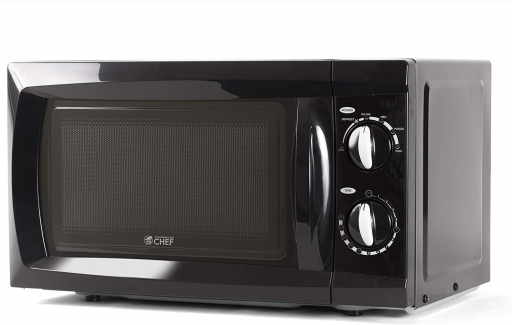

1593400462303.png1593400638611.pngI put this one in my 5x8 overlander trailer.
600 watt. installed a 2000 watt inverter. Works perfect. Small and simple manual controls. no electronics to go out.
