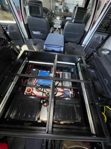

no. I have my bcdc50 mounted near my batteries in the cab under my drawer system. It’s connected directly to my victron power in bus bar and then to the batteries via 01 awg cable. I have a 6 awg cable running through the firewall to the starting battery by way of a resetable breaker.
