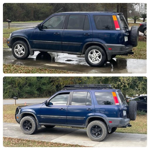

I picked this one up in the spring of 2022 for $3400 with 195k miles on it. Pre-purchase inspection showed good compression across all 4 cylinders and it needed a rear diff mount when I bought it.
Since I bought it, I've done;
Upper control arms (Detroit Axle)
Outer tie rod ends (Detroit Axle)
Lower ball joints (Sankei 555)
Front CV axles (NAPA Premium)
2" lift (ASR front spacers, HRG rear spacers, HRG 1" rear trailing arm drop spacers)
Trailing arm bushings (Truhart)
Rear upper adjustable camber arms (Truhart)
Rear lower lateral arms (Truhart, aluminum)
Sway bar links (Detroit Axle)
OEM roof basket from a local part out
Amazon brush guard and roof basket
Nilight light bar in the brush guard
Curt trailer hitch and wiring adapter
Pioneer single-DIN head unit and speakers - cheap stuff to be able to just hear some music from my phone
A few odds and ends like a couple of power window motors, the aforementioned rear diff mount, battery tray, clutch master and slave cylinders, etc.
I've been taking it out to Econfina Creek WMA, Apalachicola National Forest, and Tate's Hell State Forest a bit, it's surprised me a few times with how it handles slick stuff. Could use more torque in deep sugar sand, but I haven't had to air down yet to dig out.
Plans include more lights and a single-DIN switch panel beneath the stereo for three 1" round Nilight switches and a dual USB charger that's made to fit a 1-1/8" cigarette lighter adapter.
