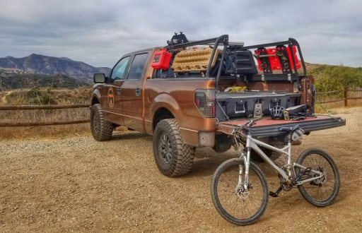

Leitner design also has a rack setup. It's what I'm running on my truck. View attachment 75144
I've been trying to decide on a bed rack system for my Ram 1500, but finding limited options out there. The Leitner system has been one of the top picks, but I had reservations about the fact it doesn't seem compatible with a tonneau cover. I plan on mounting a RTT to it. Do you find that the tonneau cover is unnecessary? would you have any suggestions?
