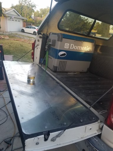

While at IMS buying steel for the roof rack build it hit me. I should just skin it. So I ran out and took some measurements and had a sheet of aluminum cut to 20x60.
Finshed product. I traced a spray paint can to get the corner profile I wanted then hit the corners with a flap disk to round them.

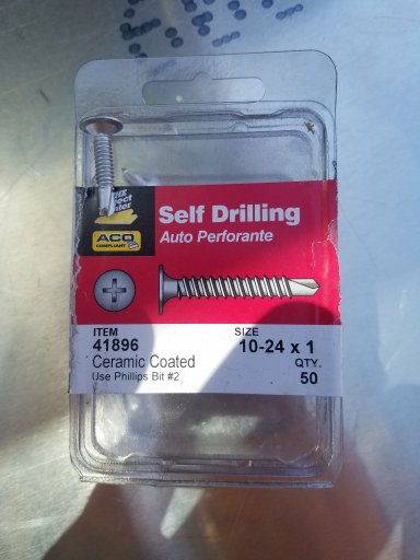

The screws I used. I drilled a hole just smaller than the screw even though they are self tapping screws. It is easier to control a drill than a screw. After placing a few in I noticed they would not go flush. So I put them all in other than the three in the two back corners. Then I found a drill large enough to get past the taper and pulled them out one by one to drill the aluminum to the larger size.
The back corners don't sit flat so a used a rubber mallet on the round over then pulled it down with the screws.
The other problem was the screws next to the tailgate latch interfered with the action. I took about a 1/4" off the screw and everything worked like a charm.
I still haven't decided on a final finish. I might hit it with bed liner or just leave it as is. I might grab a spun aluminum cup holder and sink it in to this one as well.
