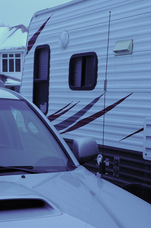

I would install it then tune it. google pic;
I've got the same 2/70B antenna myself on the fender;
