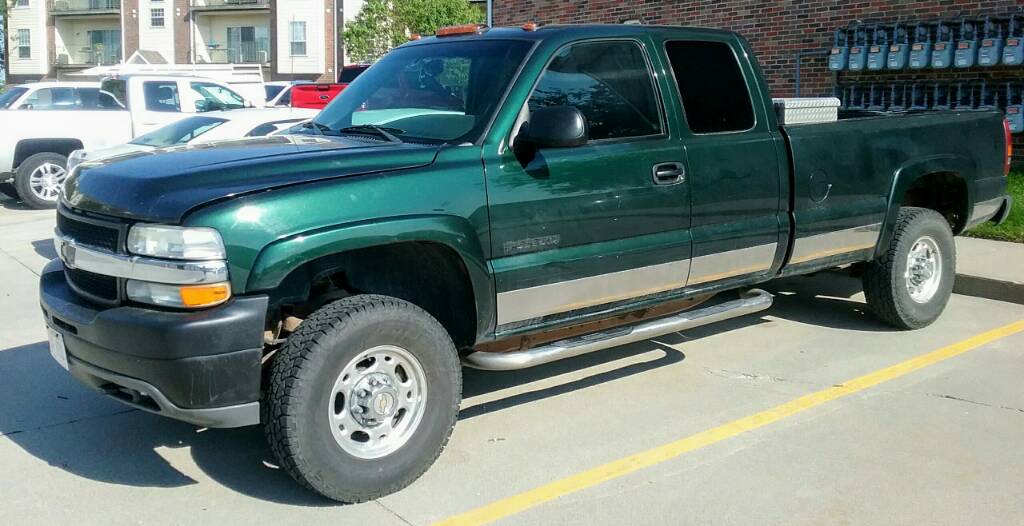

2002 Silverado 2500hd 6.0l
Extended Cab Long Box
175,XXX
She definitely needs some maintenance and some fun stuff. I've done a few things but I joined to get more ideas to make it a more capable overlander. Or at least a great camping rig.
Things I've done:
-Airaid MIT w/ AEM dry drop in filter
-Flowmaster 50 series with dual exhaust (not an off road setup but quieter than the straight pipe I ran for a year)
-Turned up torsion keys to level
-new 265/75r16 (bought them to replace ragged 255/85r16's and didn't have the funds to buy bigger. Hopefully bigger someday)
-new Kenwood head unit with Rockford Fosgates in the front. Stock speakers were shot. My wife got me the upgrades as an anniversary gift! She's a keeper.
Maintenance done so far
-had 3 exhaust manifold bolts fixed. They were broken off. Common 6.0l vortec problem
-new calipers, brake pads and lines in rear. Had done by a mechanic. Wish I had had the time myself.
Maintenance to do soon
-need to do front brakes. Plan to do this myself to save some money. Might do upgraded parts on front.
-sensor issues: knock sensors need replaced (another common Vortec issue), may need a MAF sensor (tried cleaning to see if code will stay away), and I think the O2 sensor behind the catalytic converter.
-should probably do a fluid flush. Only done oil changes the couple years I've had it. I'm sure it wouldn't hurt.
-need to have some steering components replaced too. Had it checked by a mechanic a long time ago but I forget what he recommended.
Fun Off Road plans
-aux lighting front and rear (hope for have some front lighting by September for camping trip)
-Simple complete leveling kit wit new Bilstein 5100 shocks.
I don't want a big lift because I don't want to run big tires. And I don't want it's road manners changed for long trips on highways. But the Bilsteins will be awesome because the shocks on it now are worn out.
-255/85r16's when my current tires are done. I love that size and miss the old BFG M/T's I used to have. Hope I can still find the size.
-tune of some kind. I have a Hypertech that I bought off of a friend awhile back. Mostly use it to read the dtc codes. Been holding off running a tune because of my sensor issues. Would rather find a shop to tune if at all possible.
-recovery equipment. Need a good jack to go with the tools I already carry in my toolbox. I don't have anything fancy yet.
I really hope to keep this old dog running and do some fun stuff with it. I don't want to replace it if I don't have to because I do love it. And I'm hoping to get lots of good ideas from your forum. A little inspiration goes a long way!

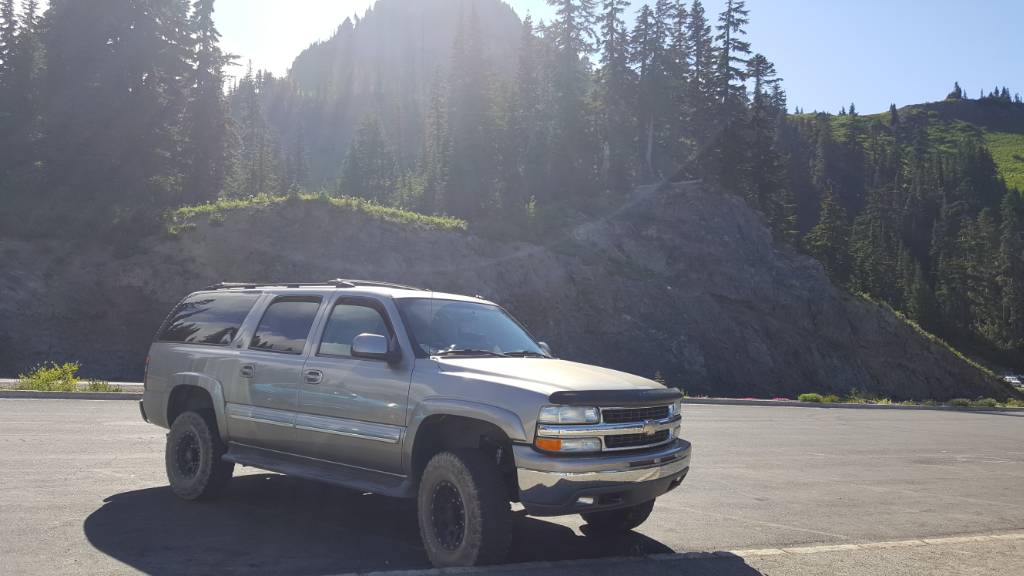

Welcome to OB! I have an 03 2500 6.0 Suburban so can relate to wanting better off road drivability. I never felt the need to hot rod my burb since I don't tow alot and performance is adequate for me. Simple drop in K&N. I am looking to replace the OE intake tube with Air Raid and stock air box. Want to keep it simple. Suspension and tires is what I invested most dollars in.
The IFS is the weak link on these trucks so I went with Cognito UCA and lift keys with Fox 2.0 shocks. The UCA will correct the geometry/ride quality (2" of droop) from just adjusting. Heavy duty tie rods are also a must if off-road there are options from PPE, Kryptonite, Cognito and Rare Parts.
Or you can go with a 4" lift from various companies like Zone, Cognito, RC, BDS and Rancho. The nice thing about the Cognito is I can still get a 4" suspension lift and works with my existing setup for a total of 6" of lift. I've taken the burb through it's paces and has gone anywhere a full-size can go very Happy thus far. Obviously doing so has me thinking more lift as there are trails I like to try that will need more cleance with 35"s. Anyhow keep us in the loop.

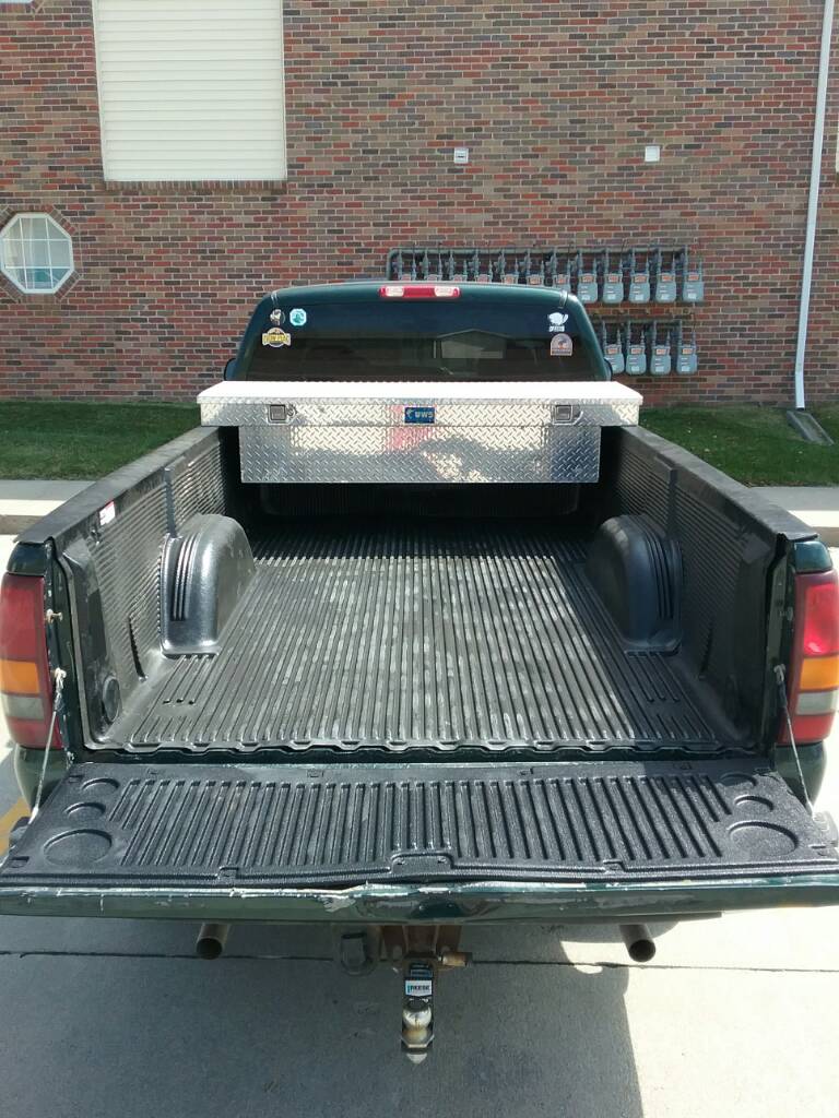

Just installed a Penda liner today! I work for an auto parts supplier so I got it for a great deal. My bed was so beat up I'm just glad it looks better. I know it limits me from installing a topper but that hasn't really been my plan. Things could always change but I have a pretty nice big tent that needs put through its paces.

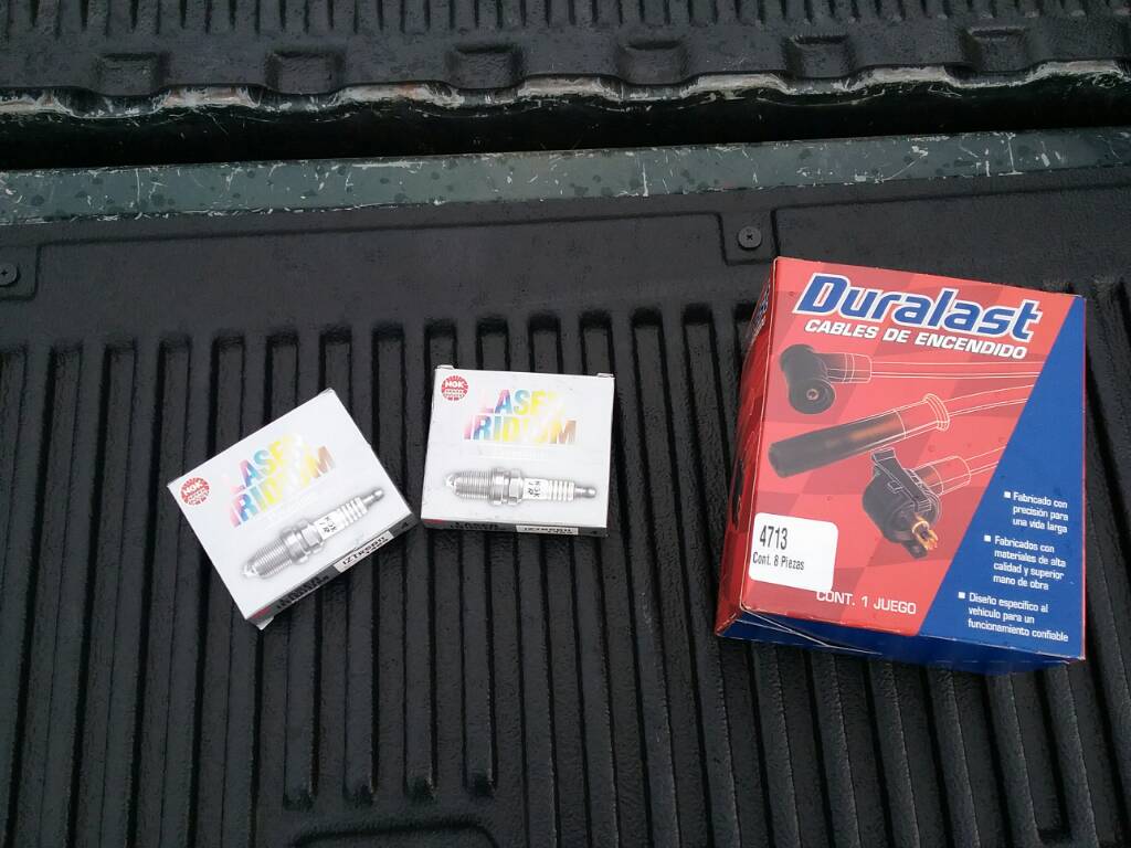

Did a little tune up today. Got a set of plugs, wires, new MAF sensor, and air filter. Didn't get any more pictures because I ran into a few issues and was pushing to get done before the sun set (that's what I get for wrenching in the Walmart parking lot). It's a little tough putting plugs into the Vortec motor. Kind of a long reach and awkward angles. Sad to say one of the new spark plug wire boots broke so I ended up reusing the old ones and taking the new ones back to Auto zone.
Broke down and bought one of these expensive MAF sensors. It seemed to do the trick. Whenever I would reset the P0101 code my truck would start up and run rough for awhile. Once I replaced it, idle was completely smooth again and the engine seemed to run good down the highway. So I'm satisfied for today. I'll see if my check engine light stays off.

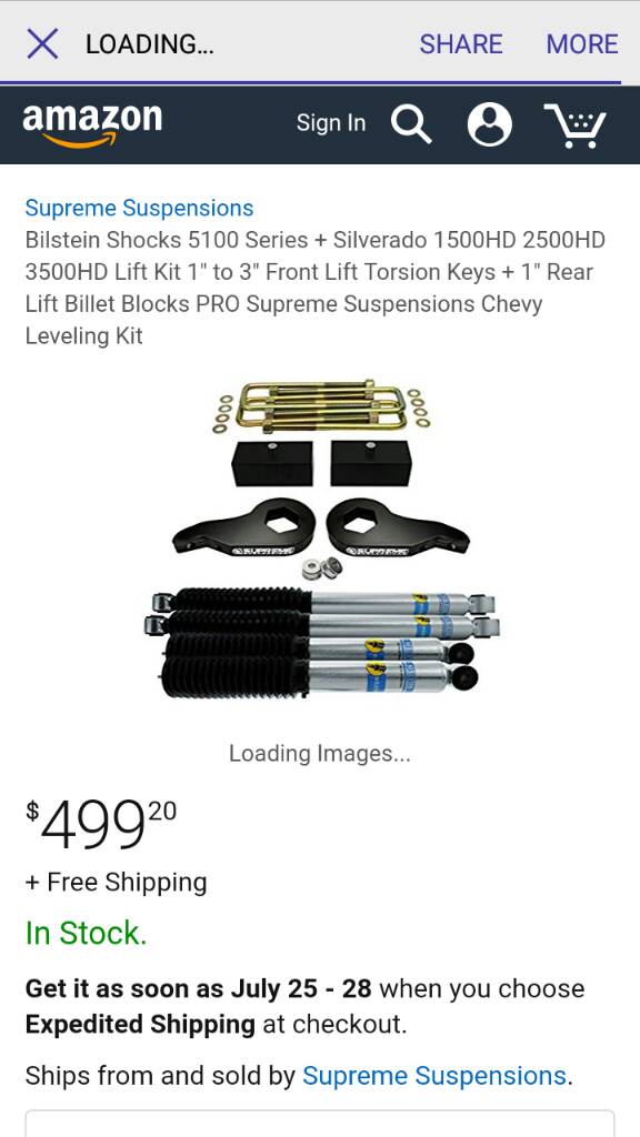

Been contemplating new shocks for my upcoming camping trip. Been reading all the good things about Bilstein 5100's and the high end Ranchos. But my trip to Auto zone today got me considering Gabriel Ultra Truck shocks. I've heard a lot of good about them. Or at least "good enough" over having worn out factory shocks. And the low cost coupled with a lifetime warranty is appealing too. I also factored in how much off roading my green monster would really be doing and it won't ever be anything as challenging as most of you guys do. So those are all the factors I'm considering. Whichever route I go, I'll post pictures and what my observations are on ride and quality.

Yeah the last plugs are set pretty far back I had a hard time getting to those out. If it weren't for that can be done in an hour it took me 2.5hrs. it's just hard to reach and awkward angle to get leverage. For shocks I vote for the Bilstein 5100. You pay a little extra but are perfect for what you intend to use it for (Street/offroad).
Sent from my SAMSUNG-SM-N920A using Tapatalk
Yeah it ended up taking me that long too... I was kind of disgusted with myself it took so long but I guess it's just the nature of the beast.
I'm really torn on the shocks. I want Bilstein's... On another forum I read "buy once, whine once".... Thanks for checking out my posts [emoji106]
Sent from my SM-J320V using Tapatalk
If you go by that saying jump to Fox 2.0 they are rebuildable..lol
https://norcaltruck.com/chevy-gm-2500-3500-2001-2007/shocks/

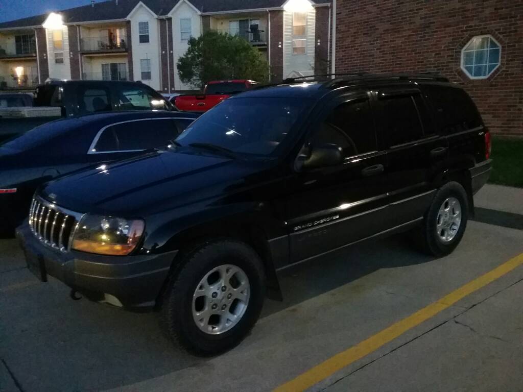

Well, turns out I am going to be posting my old Chevy on Craigslist. Overland bound has been a great inspiration to me and I found a new project vehicle.
2001 Laredo 4.7L V8 w/ Quadra Trac II
155k
Mechanic owned. Engine spun a bearing and he put a new bottom end in and had the heads machined a few thousand miles back. Transmission also started slipping so he put in a new torque converter. He even put some eBay shocks and a steering stabilizer on. He needed a pickup and traded it after driving it for 3 years or so.
And now I have owned it for 2 days! This is my first ever Jeep. I was a GM guy and a pickup guy but my brother in law has been working on me to get a Wrangler like him. Let's say I like to be different. I will probably start a new build thread for this one. Hopefully there are some WJ owners here that can get me stated on the right foot here!

Those plugs are reachable from the wheel well. I just pull the front tires and go at it.
