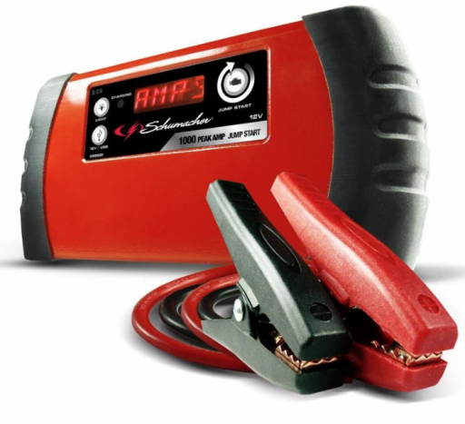

I own and love my Schumacher SL1. Be careful going with an unknown brand on these battery packs. They're designed to dump a lot of current in a short amount of time. If they are low quality or designed poorly this could mean fire.
I will check this one out. Have used other schumacher battery smart trickle chargers with good results. Need one with enough.....uumppphh for a a dual battery 6.6 diesel. I need a minimum 800 amp version.

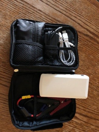

I have the antigravity for my wife’s Grand Caravan and I just bought a NOCO gb50. The antigravity has been used with success in the past. I have yet to test the NOCO. Size is a plus versus the jumpers and being stuck with a dead battery is an unacceptable situation. NOCO for $100 seemed like a great deal.

I’m hoping I don’t ever need to use my NOCO . My wife’s Caravan needed a couple jumps and the antigravity battery worked even after sitting for a long time. I was kind of surprised. I used it to charge a phone a few times. It seems like it was a decent product. We got it as a gift, so I can’t complain really.
