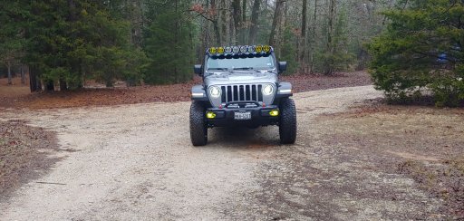

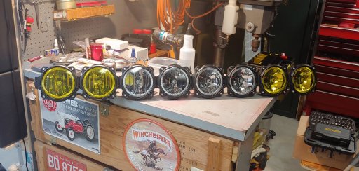

Work great during Snovid 21. In that photo the clear center lights are covered, what you see are the 4(outer) KC Gravity Pro 6 with amber Lamin-X, the oem led fogs with amber Lamin-X and the oem led headlights

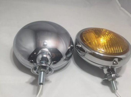

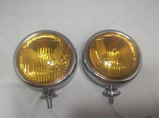

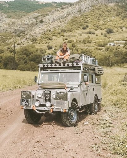

Hoping to install fog lights on Grover this year - it's not the highest priority.
On the old Series Rovers the fog lights are usually on the front bumper. Following pics are typical placements.
What's interesting is the "clear vs amber" discussions - plenty of pros-n-cons to both. I'm planning on going with amber so tge glare isn't so harsh. The last pics are what I'm going with.
