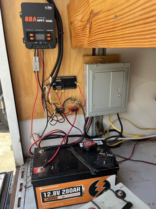

I use #6 wire going from battery to fuse box. if you are installing a charge gauge, then you will be using a shunt on the negative, so I go with a #6 from the battery to a shunt and then #6 from shunt to fuse box.
I did mine this way and I used 12ga wire to run a short whip from the fuse box to my Dometic fridge and I ended up having to go with a 10 ga wire because of the voltage drop caused by the resistance of the 12 ga wire. To get the same power of 120vac, you will have 10X the amps using 12vdc, so big gauge wire is a must. I use #6 because I don't have a lot of DC loads, but if I did have a lot, I would probably have to go up a size
#6 wire is rated for around 60amps
Depends on the length, amperage, and what you are powering. I'd refer to THIS CHART. Also, is that circuit breaker an Amazon special? If so, it will probably melt under heavy load. They do that. Most of those cheap breakers (and fuse holders) are not capable of the amperage they claim. Sometimes they even cause more resistance in your circuit causing equipment to overheat and eventually become damaged or not work at all - which is not good. The fuse block looks like Blue Sea (that's good to me). I'd look at places like McMaster Carr or even Blue Sea for a replacement breaker or inline fuse. That's my two cents.
yeah...that is a good point about buying off amazon. I use blue sea fuse boxes and they are well built and have been used for marine applications for a long time and have a good track record. there are a LOT of knock-offs on amazon that are cheaper and are not good. I bought an off brand fuse box for a power station build and it was garbage. I ran a 12v sure flow pump on one circuit and when it was running, it would pull down the circuits running lights and cause them to brown out. very cheaply made and even dangerous, because it will overheat operating at a fraction of the "rated" amperage.
also while we're on it...watch what wire you buy. China has been putting out copper clad aluminium wire for quite a few years and a lot of people are getting it thinking is a solid copper wire. even residential electricians were using it thinking it was solid copper. you can read on why that can cause problems, but when you buy wire, make sure its solid copper.
Im currently redoing some of my circuits, but this is pretty much what I ended up with. I used an Anderson plug on the end of my solar panel input so that I can easily hook it to the solar controller to charge the main battery...OR...I can unplug and plug in another battery and charge it off my roof mount panels. Went with the Blue Sea fuse box and used bulkhead mounted terminals so that I could wire in the shunt and have it not right on the battery...remember, you need to wire the shunt so that ALL power goes thru it, charging and discharging, so that you will have an accurate read. I don't charge my battery off of the generator that much, so I just have it so that I run the Genny and use a regular car battery charger to charge the battery. Plug it into the Genny and alligator clip it to the terminals. Since I'm not going thru the shunt this way, it wont show the battery being charged, so I top off the battery and then reset the monitor to 100% after charging.
I try to stay away from the cigarette lighter type plugs. My Dometic fridge came with the 12v cord with the cigarette lighter plug on the end so I bought the female plug to go with it. It disconnects a lot on bouncy roads and I lost some food once because of that. Id go with Anderson plugs if running a 12v fridge. I do use those type of plugs for my portable 12v fans, but I use them when Im stopped, so no problem using them for fans.
