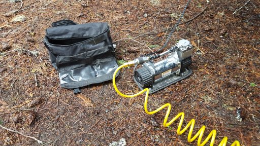

I’ve had this cheap harbor freight compressor for about 6 years now , it’s a little slow and loud but gets the job done it’s done everything I’ve asked of it from stock tires on a forester to 37s . The biggest issue people have with these cheap little compressors is hooking it to the tire before turning it on , it overloads the motor causing it to get stuck and blow a fuse . Turn it on and then screw it Onto the tire And it will serve you well . One advantage of a slow compressor is it gives you time to re-organize some of the stuff in the back your rig , Check over the vehicle to make sure nothing is loose or damaged , Get some good stretches in to limber up your body after sitting for so long.D1512232-A139-41A8-BF40-EC18C9CB99D4.jpeg

I also run a harbo frieght compressor identical to the one above, it works well enough.
After so many years of use it’s definitely getting slower and louder but keeps chugging along . I also took out every screw and added a drop of green locktite just to help keep it from rattling apart .
