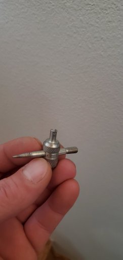

Spend $9.99 and have this in the tool bag. If you tear off a valve stem you'll need this to pull a new one through the hole unless you're really really good with a set of dikes. LOL
