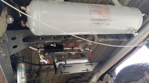

Check with Don, don't think he is on these forums, for what he built for his FJ. He fabricated a frame for a tank and compressor under his rear bumper. It was pretty slick. I'm sure he still has photos.
Here's the thread on the blue forums:
http://www.fjcruiserforums.com/forums/4x4-off-road-tech/235201-extremeaire-compressor-install.html
Reactions: Gunnermoose

Looks good, whats with the bike cable lock coming out of the hood? Bumper theft prevention?
Also just a little heads up. The wire ziptied to the SS braided line may chafe and wear thru causing other issues. Wrapping the SS line with electrical tape then doing what you did is fine since the tape can not move on the SS braid and wear thru. Still a great setup man and a good setup as well.

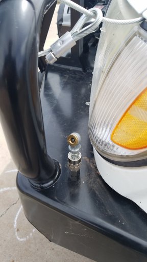

Cables coming off the bumper are limb savers, stowed under the hood when not in use.
Ya, another forum member advised me against routing the wires there as well. I have since rerouted them away from the braided air line.
Reactions: Kent R
