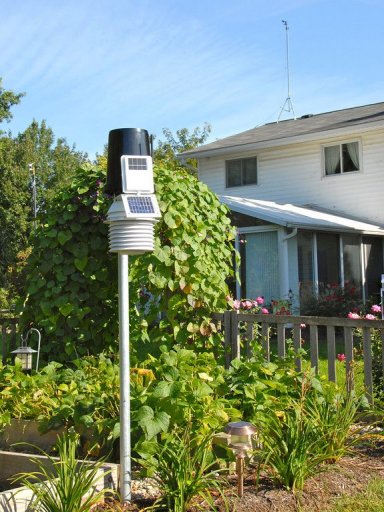

Tricky problem with location for the thermo sensor. As an amateur meteorology enthusiast, I know that weather sensor siting is one of the most overlooked part of an accurate setup.
You won't want the sensor anywhere on the outside where it is exposed to direct sunlight, else it will read like a bank thermometer on a sunny day. But you also don't want it tucked up against the roof, especially on a dark vehicle, or it will be exposed to radiated heat from that surface. Ideally, it would be somewhere under the front where it is shaded and gets good airflow. But that exposes the sensor to road and engine heat.
Those of you with a RTT might try locating the sensor on the underside of the tent where it is shaded, gets good airflow, and is away from body metal that gets direct sun. It is still going to read high sitting still, as the road heat will waft around your vehicle.
I don't know where the sensor is on the 4Runner, but the dash temperature reading is within a couple of degrees of the correct ambient temperature.
Here's my home setup. The unit in the foreground contains the rain gauge, thermo/hygrometer sensors, solar, and UV sensors, with a fan to aspirate the sensors. There is a separate transmitter that sends soil temperature and moisture readings. On the roof you can see the anemometer. This info get sent to my computer, where it is compiles and sent to various weather data collection associations.
